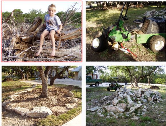

The guy I bought the tractor from had a 60" finish mower so reversing the wheels is still narrower than the tractor footprint.

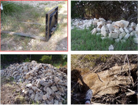

#64
more rocks

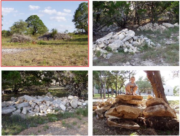

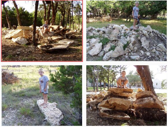

#66
more slope
