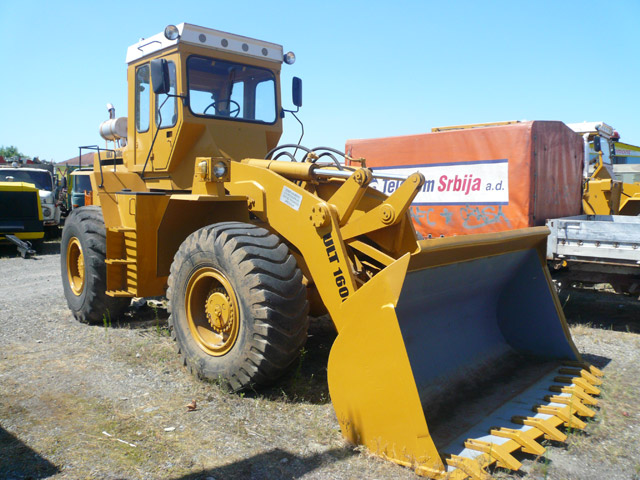

Is that picture the actual machine? If it's close to that size, I might approach it in the way wheel loaders and snow blowing is handled - with and auxiliary motor and pto/clutch. This would remove all guesswork as far as damaging the loader in any way by tapping into its hydraulic system that as the other guys have mentioned was not intended to be a hydraulic power plant for auxiliary attachments beyond possibly a pair of cylinders on a "4 in 1" bucket.
That's definitely enough machine to carry this arrangement easily. There are companies here in the United States that sell pto/clutch units that have standard bellhousing bolt patterns for 540 or 1000 (or both) rpms. I can look for a link if you like.

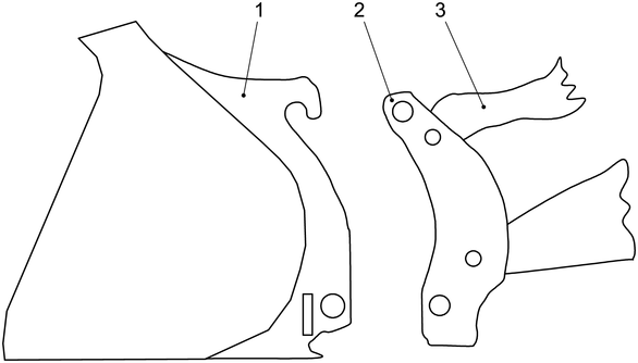

Does the wheel loader have a quick coupler for the bucket?

@Rustyiron Yes it's exact machine ,only friend loader have Cummins engine ,195-200hp,that on picture is 160hp engine.I not understand u very well,u mean maybe something like this ?.engine ,actual engine in front to power that mulcher with its own pump and hydro motor ?.

@IndustrialToys We not have hills here ,everything is flat ,but i forgot to mention,loader would clear mainly farming fields ,that were not used for over decade and they grown in that wild bushes.So no hard ground for him,plus it have chains for tires ,not snow chains ,but those chains like we see when loaders are working near smelting furnaces or idk how to explain,they cover tire almost completely,protect it from anything.
Btw loader is lifting +-6 tons easily ,we lifted whole tractor with it,and maximum lifting capacity is 14 tons,ofc no point trying lifting that it would just lift his rear end.I see on net many smaller loaders with similar operations ,no extra engine ,just their own hydraulics,we would not allow ofc for hydraulic oil to overheat.Oil coolant is a must,but mainly more or less for our own needs,we try not to invest allot of money,u wouldn't believe how much this loader was cost,just to buy tractor mulcher and some hydraulic motor(both used ,not new) ,it would be maybe even expensive as much as whole loader.
We planned to buy just some hydro motor and mulcher,with that price invested,if we just mulched what we have for us ,it would pay off it self easily.Because companies that are doing this type of job ,are just far tooo much expensive here,we called several of them ,and prices are moustly same,expensive.
Anyway if it can't work,loader was only something as idea,due to his lifting boom it would really make job much easier ,well we can still use tractor ,but just as i mention before,those bushes are very high,and branches are mixed up somehow,it's all connected,hard to mulch it from ground level.
@Xfaxman Yes,but it's not mounted on him,we didn't have use for it,we use just one bucket with teeth on it in V shape.
