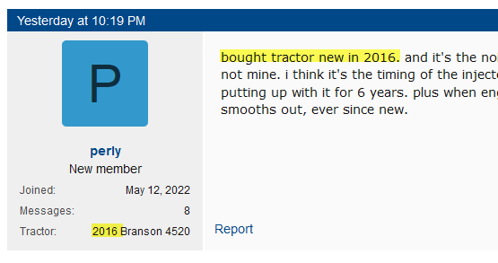

2016 Branson 4520
bought tractor new in 2016. and it's the noisyest clattering engine. since new. i know some engines clatter. and most are nice tight solid sounding engines, not mine. i think it's the timing of the injecter pump. but i don't have enough knowledge on the subject YET. anyone know what i'm talking about. been putting up with it for 6 years. plus when engine starts first starts cold, it coughs, and sputters, and pukes out white smoke for a few seconds, then smooths out, ever since new.

Presumeably it's the 2016 Branson 4520 in his profile.
For the cold starting problems I'd make sure the heating system is working. I think it's an intake heater rather than glow plugs, but has the same function.

when i say cold start, i don't mean cold outside. i mean first start of the day. don't matter what the temp. is it runs like crap when first started, then smooths out.
