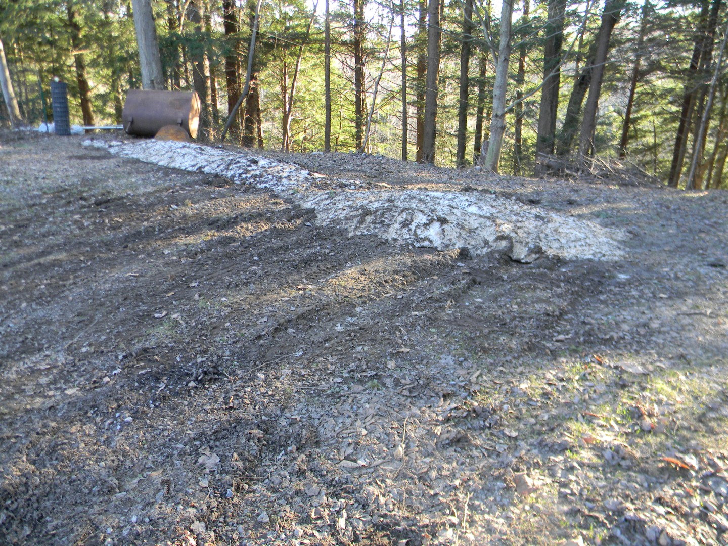

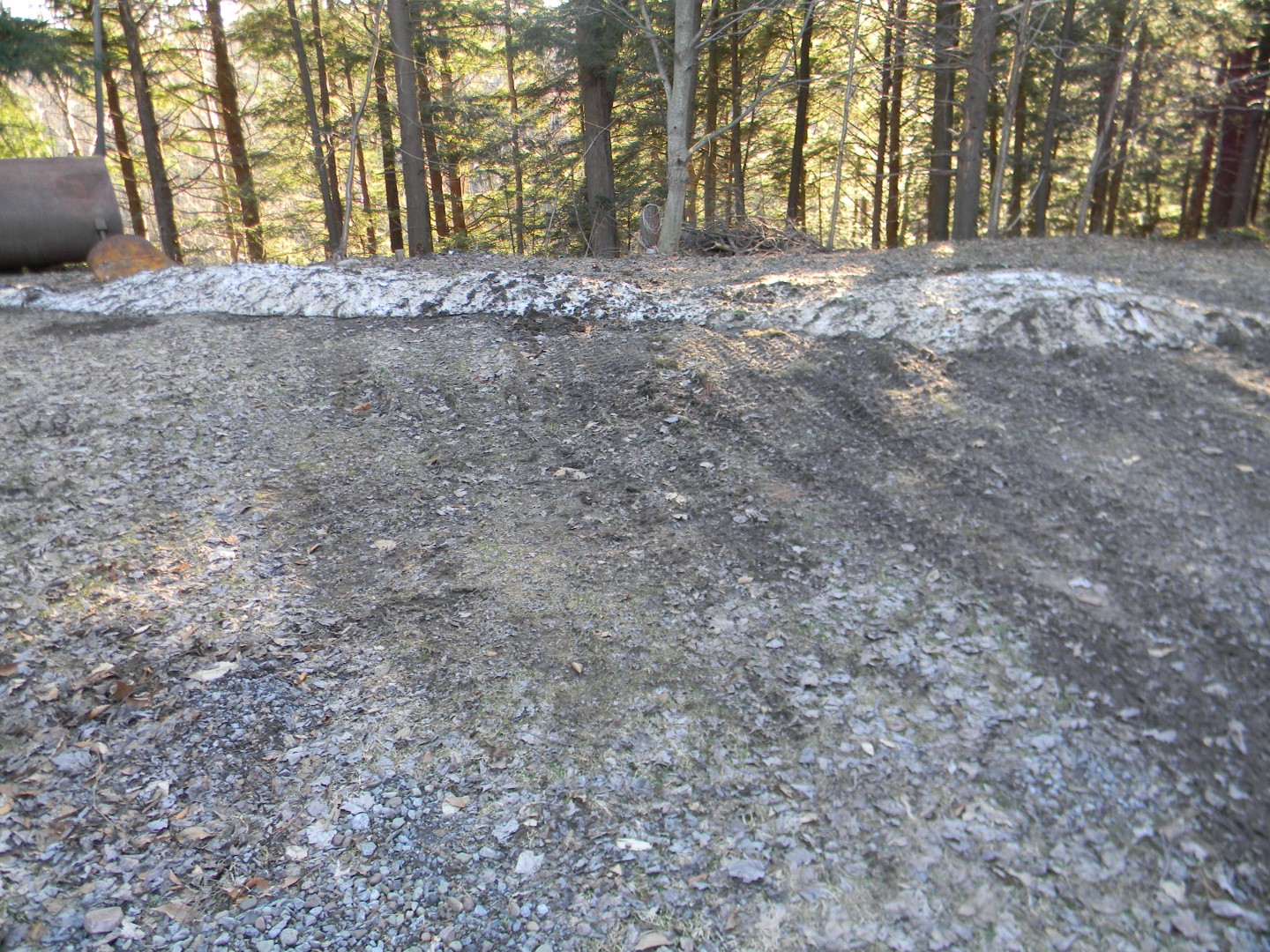

Has your snow melted ALREADY?
Not completely melted here. I still have a pile about 6-8" in the yard where I had pushed it back. A couple weeks ago I back dragged the piles to help it melt faster.
