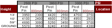

Don't get wrapped up too much in the loader specifications. Numbers can easily be skewed. There is a love hate relationship between the lift capacities and lift height of a loader. If you lift higher, you loose capacity. If you don't need the high lift, you can gain more capacity for digging and breakout force. Some loaders based on their design will be better dirt/digging units. So it really matters what you want to do with your loader once you have it. Just make sure you are comparing "apples to apples" measure at same point, at same PSI and GPM. Best comparison number is at full height at front edge of bucket - this will give you a "true" working capacity of a loader.

Once specs are published, they've been tested thoroughly. I'd check the Pressure they were both measured at. It makes a huge difference. Example... See chart below. In this example you can actually "loose" or be mis-led by 1650 pounds of lift capacity if you compare it from pivot point to actual working load capacity at the front edge of the bucket (800mm is standard on larger loaders, I believe 400mm is for small compacts but I'd have to look it up on the gov. stds. to be sure) Even from 2500 to 3000 PSI you can lose 800 lbs of capacity. This is obviously an example on a larger loader, but it is porportionally the same in the smaller ones. Do either loaders list capacity at front edge of bucket? or spec cylinder sizes? The capacities are similar have you considered other features between the two? Pin sizes, quick grease pins, way it dismounts, is quick change bucket coupler standard, what kind of attachments are available, are they expensive?
