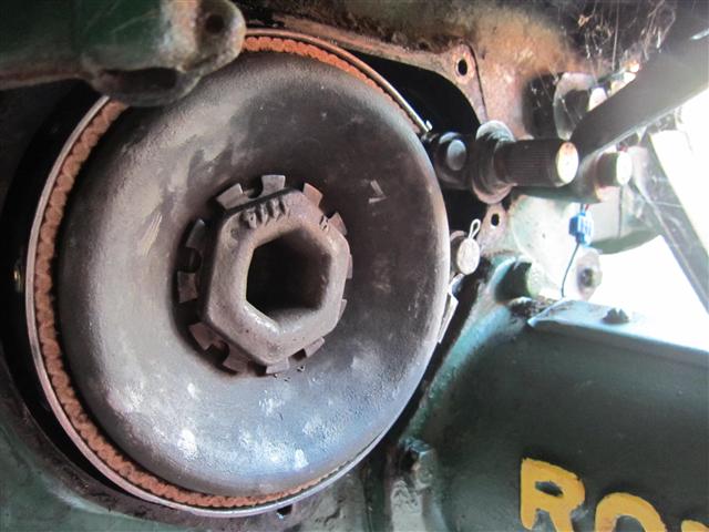

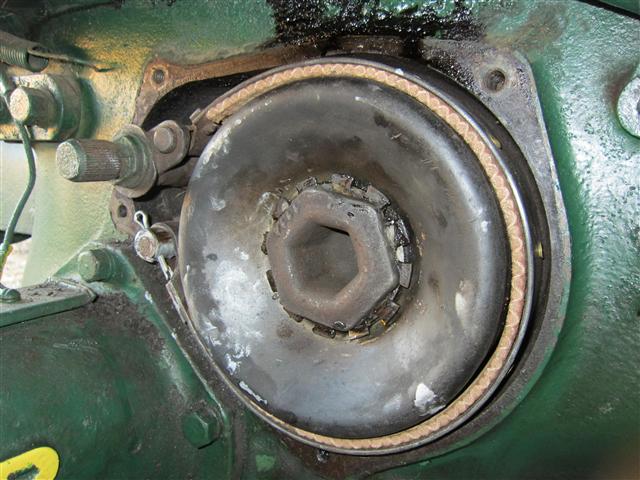

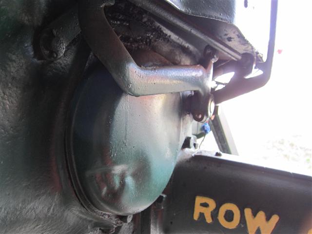

My 1945 Oliver 60 has those type of brakes, mounted on the differential rather than on the rear axle.
The brakes are forward of the rear axle under the circular shaped cover
The brakes are band-type units that grip the drum from the outside when you hit the brake pedal.
The band linings were pretty worn and oil-soaked (failed seal on the brake axle shaft). Had to rivet new linings onto the bands and replace the seals. That job was not difficult since access to this type of brake is excellent.
