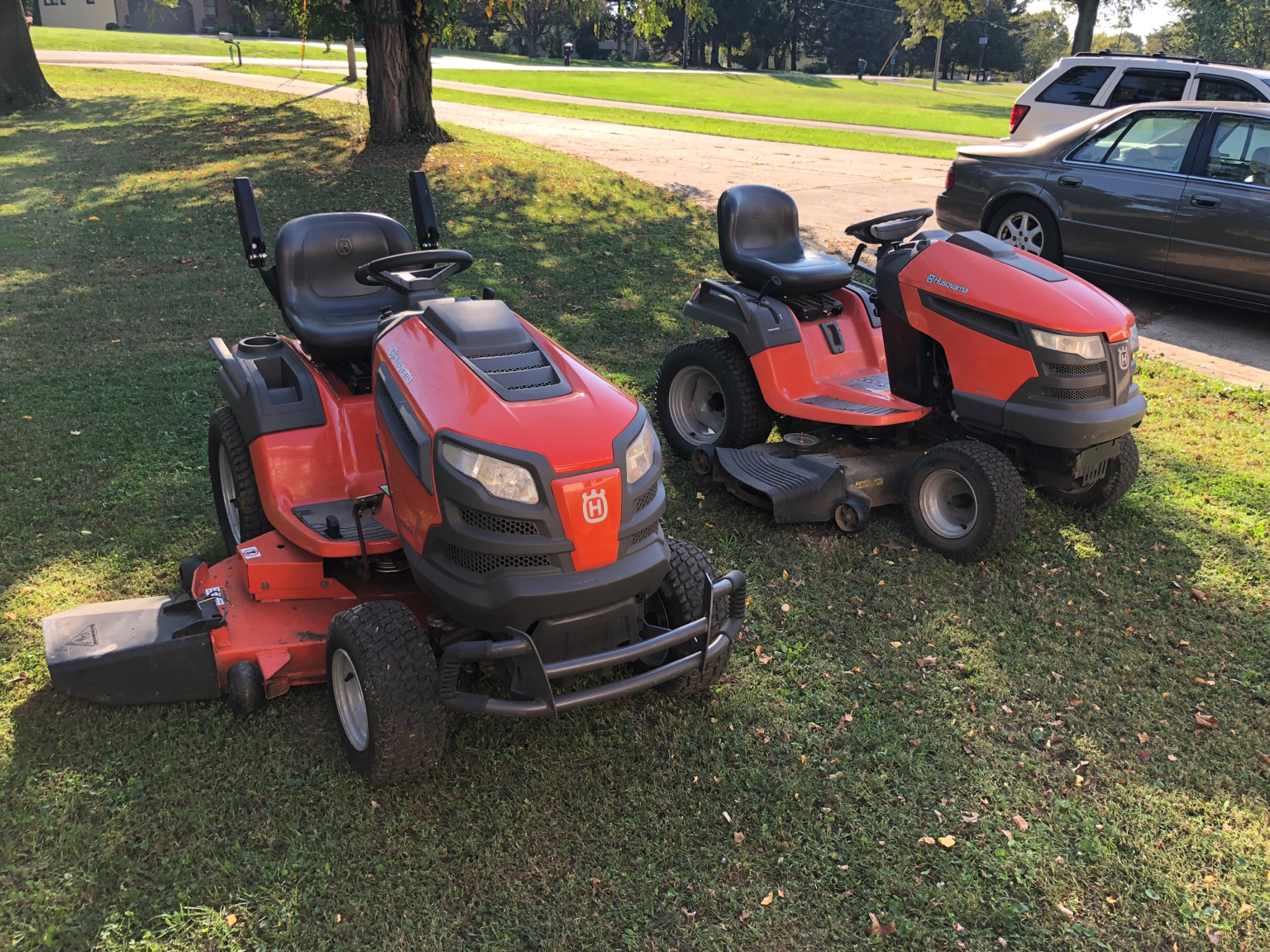

The ts354 is probably the baddest of the consumer riders from Husq as far as I can tell. I have a GT52XLS and it is a beast. I think this is the closet to that without spending $5-7000 on a Deer.
   / What's the biggest and baddest Husqvarna garden tractor for 2019?
That's exactly why I bought it. In the price zone of $3,500 give it take $1000.... There is not a single product that even competes with it, let alone beats it.
Sure you can double the money and go green to beat it. But in this same price range even team green doesn't want to step into the ring against this lightweight champion.
