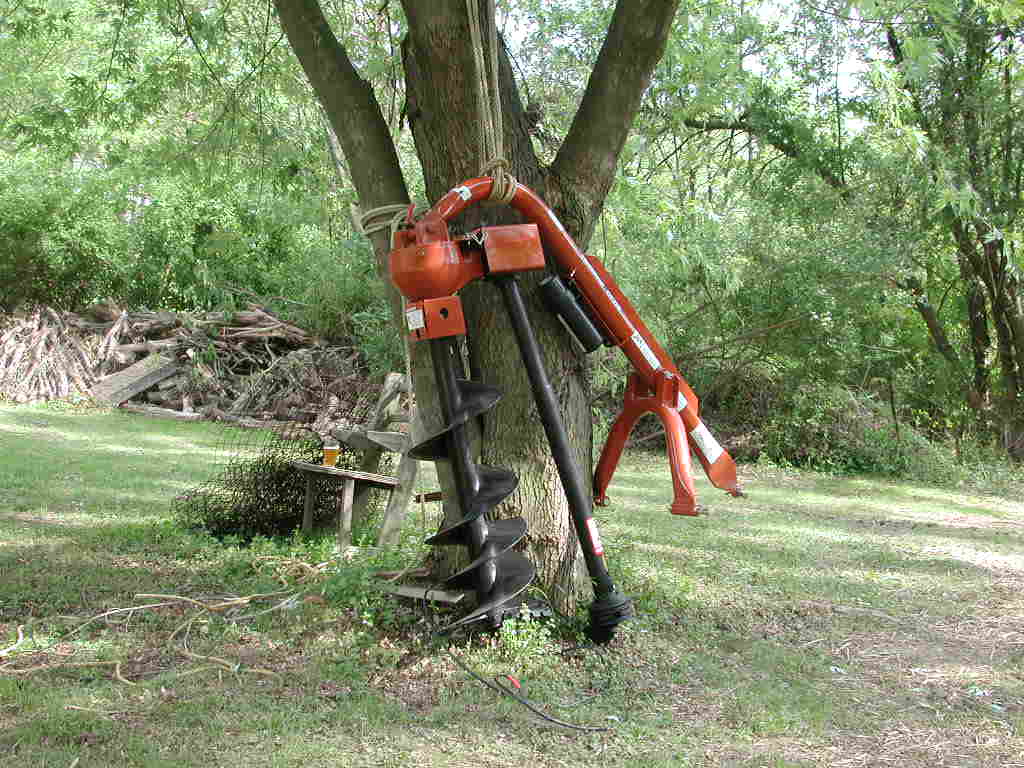

In the past, I've seen some nice 3 pt implement dollies in the forums for back blades and tillers (even for a chipper)... I bought a Post Hole Digger and was using it today....
So, what is the best way to store a PHD? Anybody have a picture of a special home built dolly for storing one?

<font color="blue"> Anybody have a picture of a special home built dolly for storing one? </font>
It's not a dolly, but it works! /forums/images/graemlins/blush.gif
