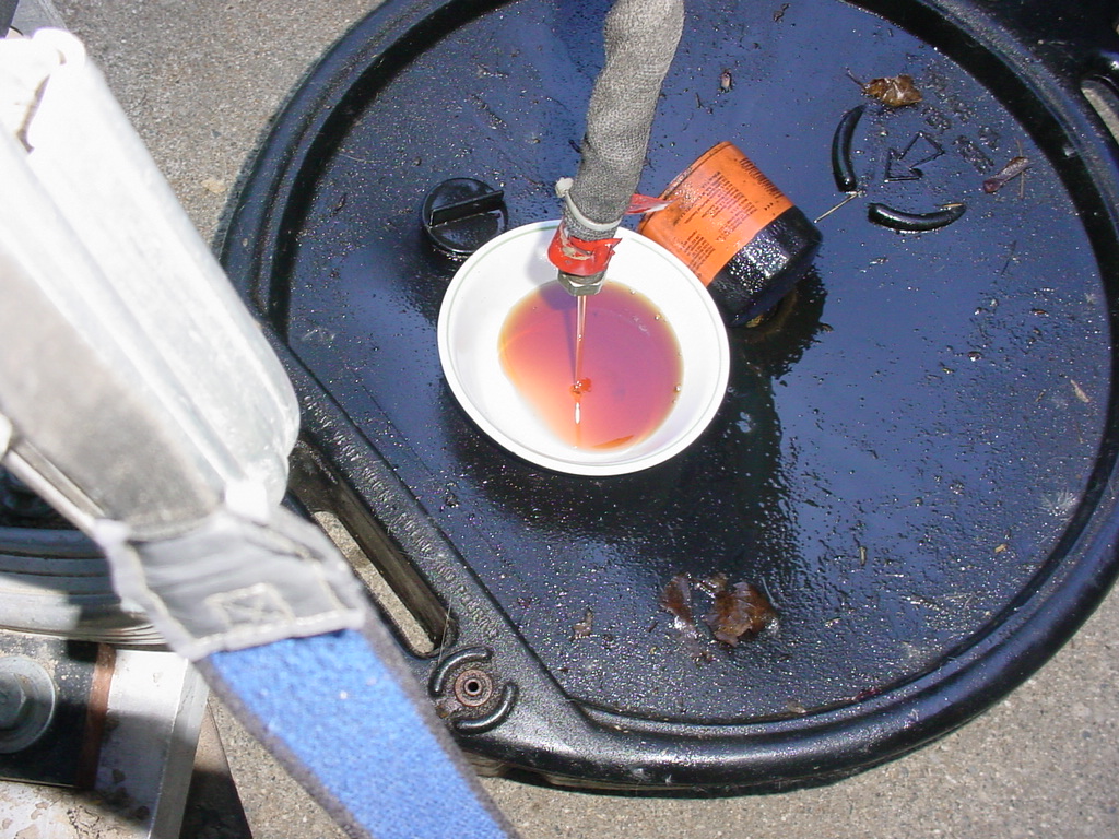

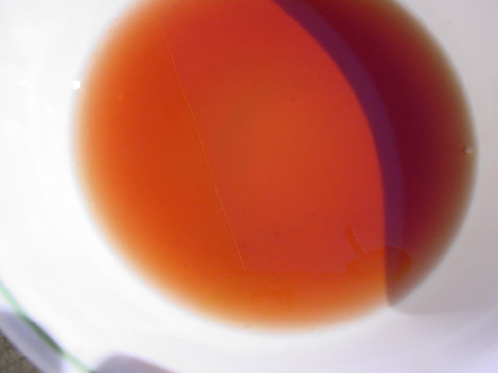

I like Gary's suggestion to stroke the cylinders and would discharge the fluid in a white bucket to see if there is any metal flakes or debris. Better safe than sorry.
Don't forget the pics.

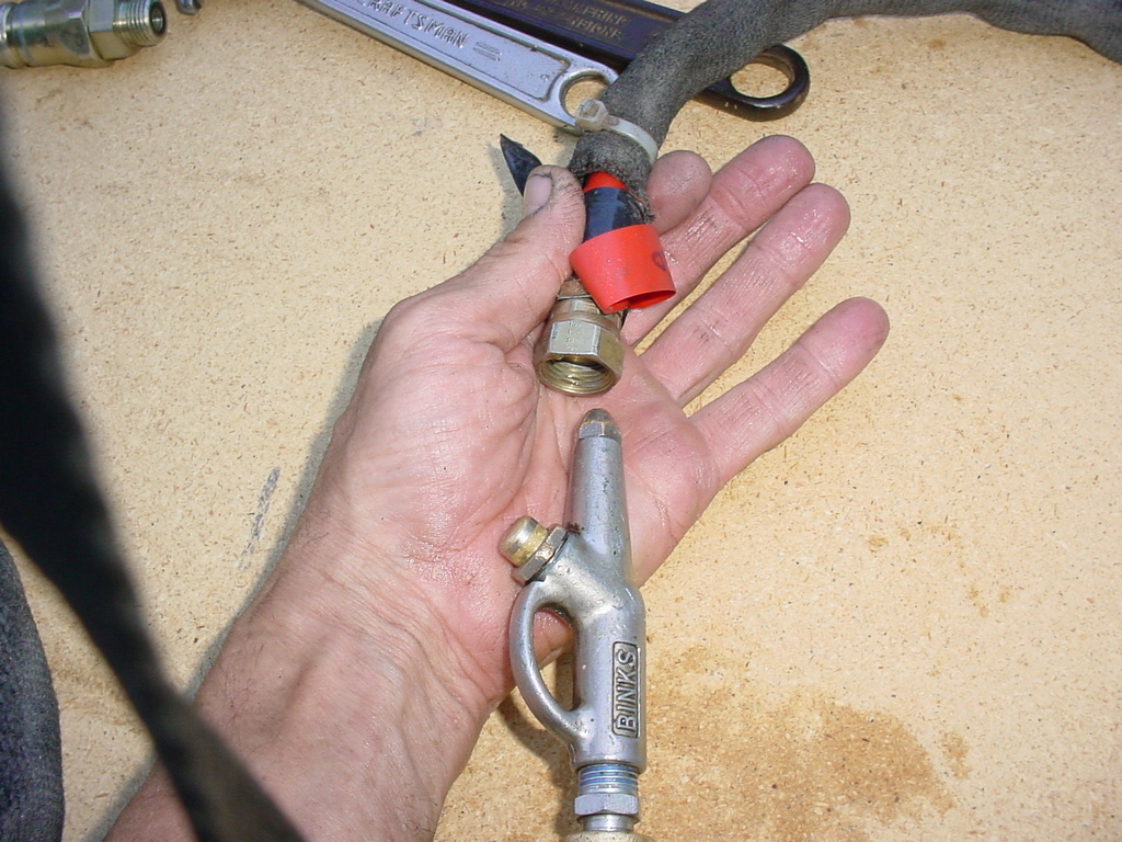

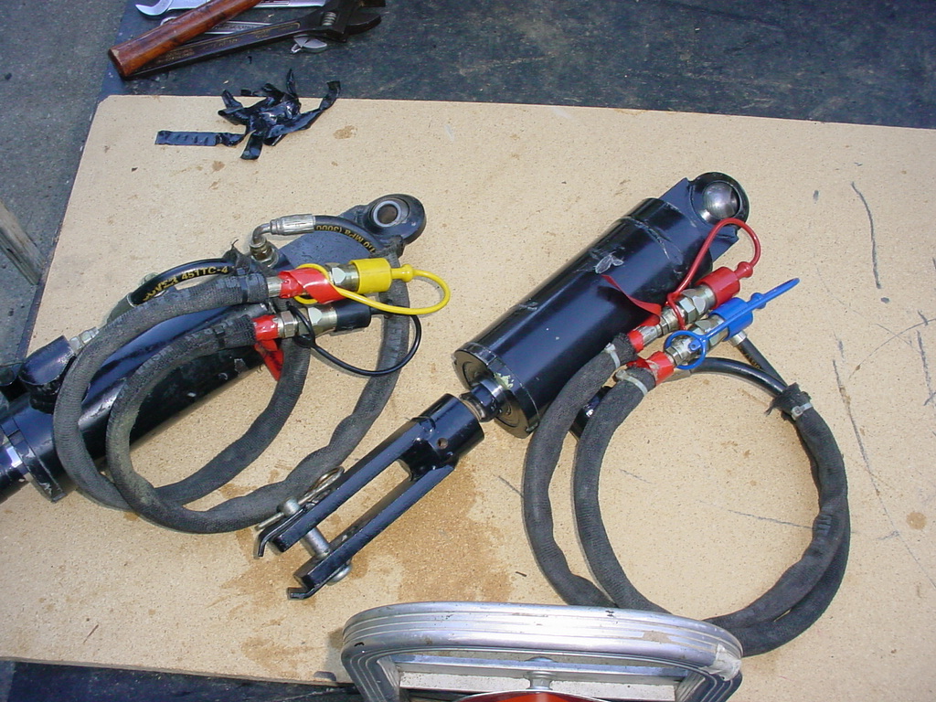

I tried manually pushing the cylinders back and forth, but they would not move. I guess I'm not as strong as I used to be (come to think of it I never was that strong). I removed the quick connect fittings from the ends of the hoses and used my air compressor to get the cylinder to move. I used about about 10 lbs of pressure. The oil that came out looks good. Thanks for all the help and suggestions.
all set and ready to go

Something to consider: Air works great for cycling the cylinder but if disassembling one, the rod/piston can shoot out like a missile. To have control of the rod, I have a "V" trough made from a 2x4" & 2x6" boards screwed together which the cylinder is set in. Across the ends are 12" long pieces of 2x6" with an eye bolt in one end end. (Weld the eye bolt shut.) The is where you anchor the base of the cylinder to. You can do the same thing to the other end so you can use a come along or mount a hand winch to pull the rod out with. (Safety chain around the rod going back to the base with 6-10" of slack would be a great idea for when the rod pop free.)

Looks good, so you have a Deere tnt set up now for your box blade. I think you will really like it and mine is the same thing, been using it a lot this spring.
