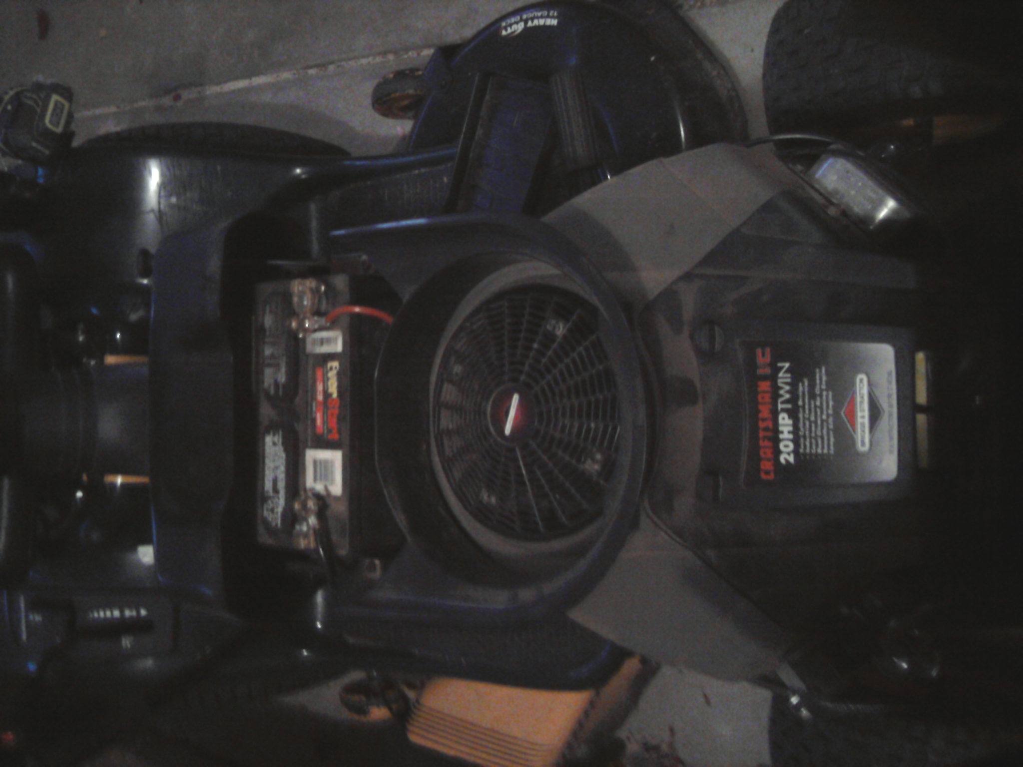

When I got my JD 318 recently there was no battery installed. I know sometimes a larger battery can actually fit in the battery box compartment than the stock battery from the factory. Can anyone steer me to the direction for the best SIZE and BRAND of battery. I plan on keeping this tractor in the garage and will be holding on to it for years to come.
Thanks in advance for any recommendations.

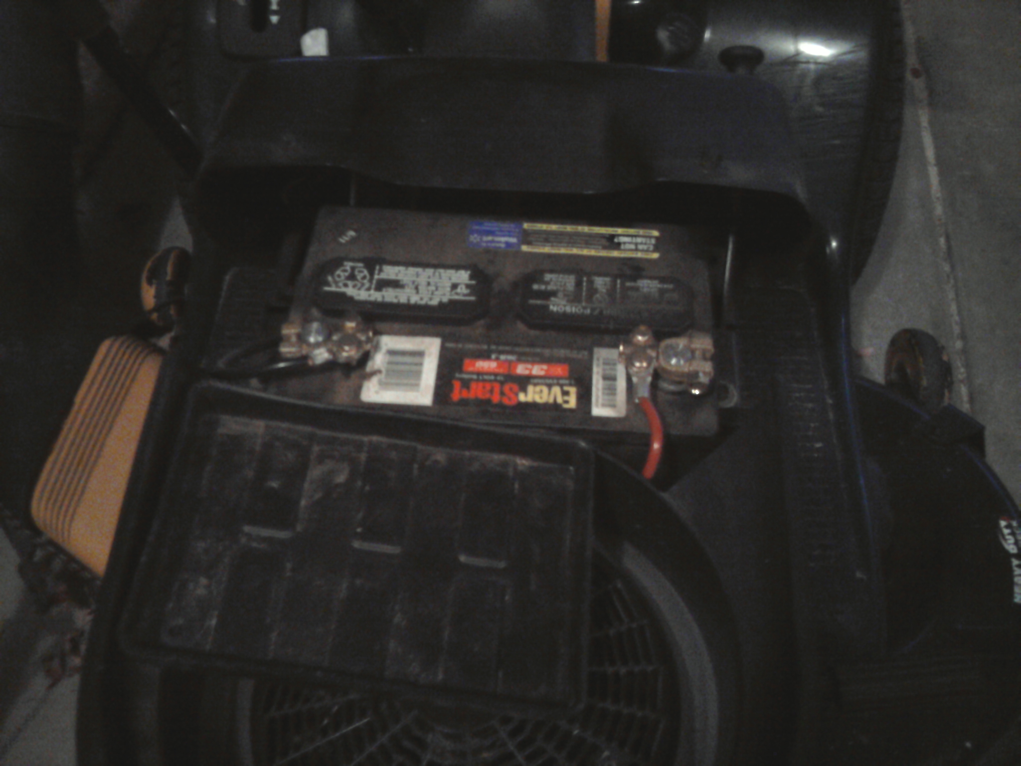

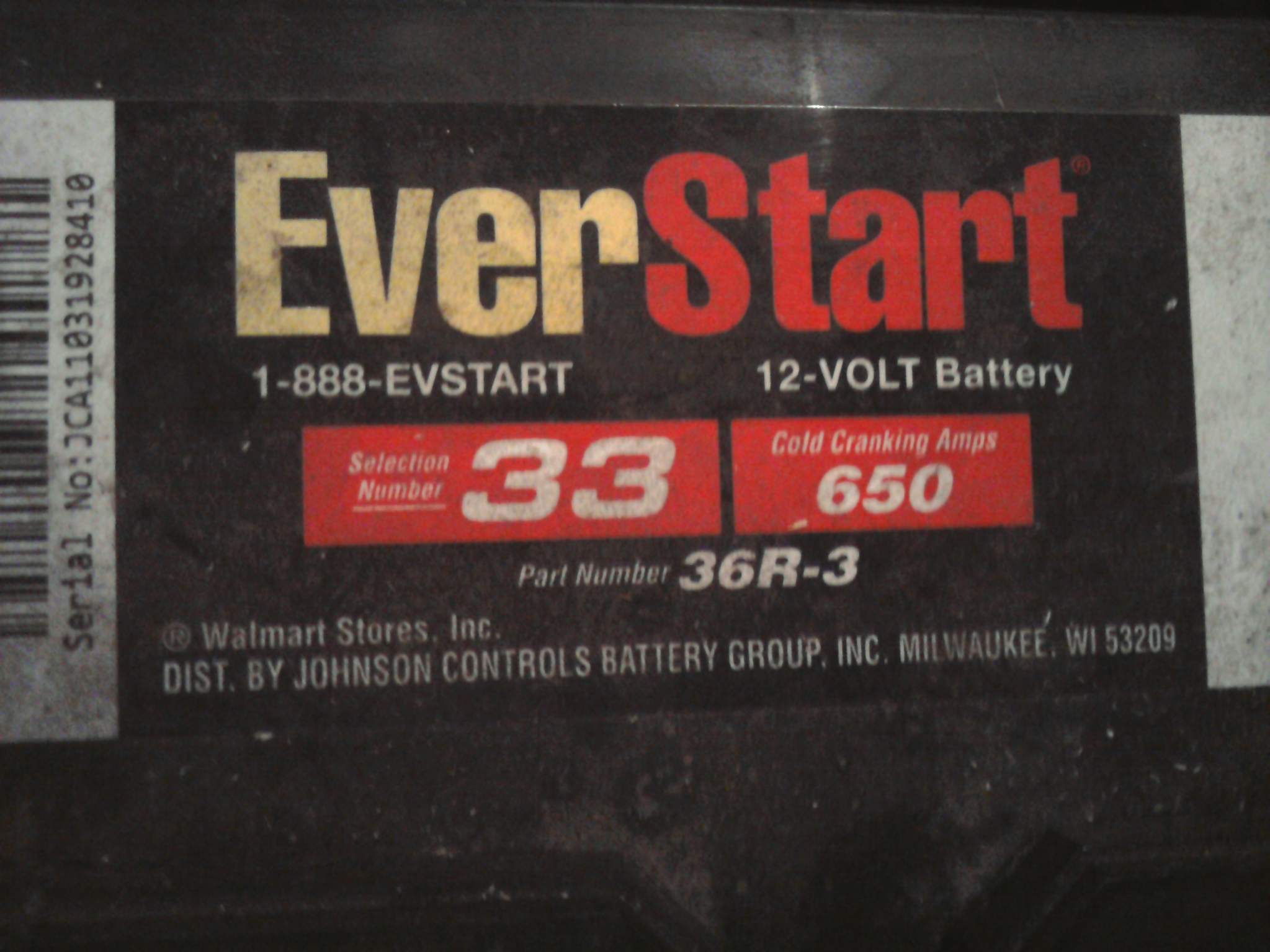

You can use anything that is 12v the amperage wont matter, more is better when it comes to amps. The small tractor batteries suck, about 145 cranking amps vs. 700+ with a larger one for a car or truck. I use the biggest battery that could possibly fit in there. I have been using the walmart brand battery for a little over 2 years now and it has worked just fine. The bonus is you can run other things like lights, horn, winch, etc with out having to worry about draining the tinny battery. The black tray in the last pic is that the original "tractor" battery used to sit in, you can see there is much more room in there, but if your battery is under the seat your out of luck.
