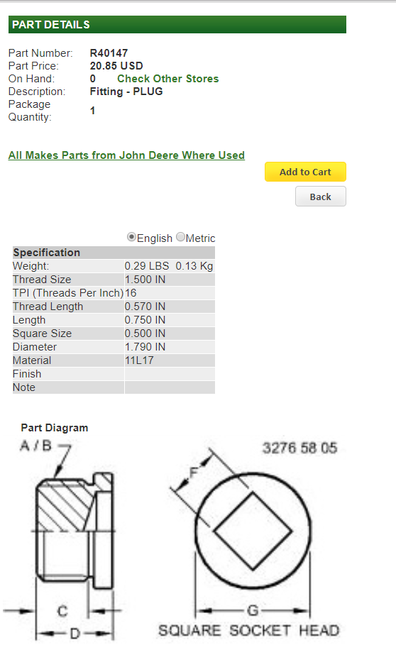

1st thing you need to check is frt hyd pump drive coupler. It's possible the bushings(AR49427)&/or couplers halves are worn. When you replaced FEL control valve did you install a closed center conversion plug with proper seals?

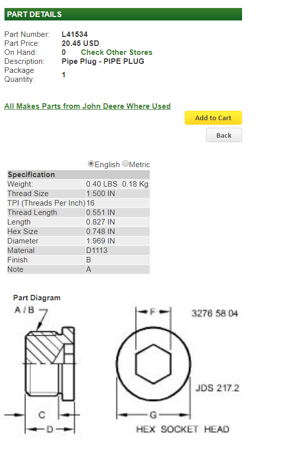

Tx Jim. Thank you for your reply. I ordered a rebuilt SCV and specified it was for a JD 3020, serial number above 123,000. When it came in, I just swapped them out. I did buy new bushings, but haven't had time to work on them, yet. (Hence, my late reply to you) I did learn that if I depress the clutch too long, it starves the pump and the FEL won't operate. On the dipstick the hyd fluid looked and smelled fresh. I changed the filter today, and what drained out looked like old motor oil, but thinner. The old filter had almost no debris on/in it. I was going to pull the screen to check it and drain the system and start with fresh fluid. I was told to use a 1/2' breaker bar in the square hole on the filter cap. When I got under there, the hole was not square, but requires a fair sized Allen wrench. I own enough tools to disassemble a locomotive, two airplanes, and a bicycle, but since we are living in temporary quarters, they are all packed in storage. Would you happen to know what size Allen wrench is required?
   / What's that noise!? Please tell me it isn't the hyd pump. #6
JD parts specifications calls for a 0.500 sq hole.for screen retaining plug on a '69-'72 3020 BUT I'll guess someone installed a plug(2nd photo) from a JD utility tractor tractor built in Mannheim factory.
