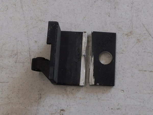

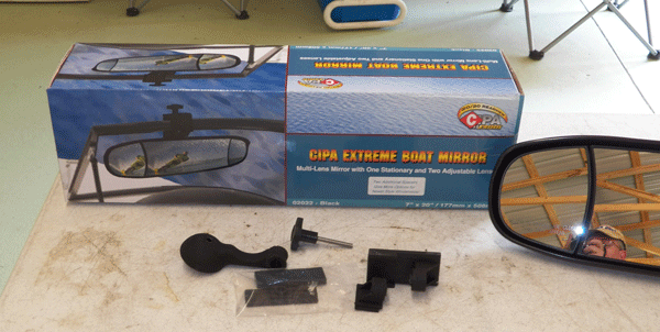

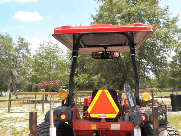

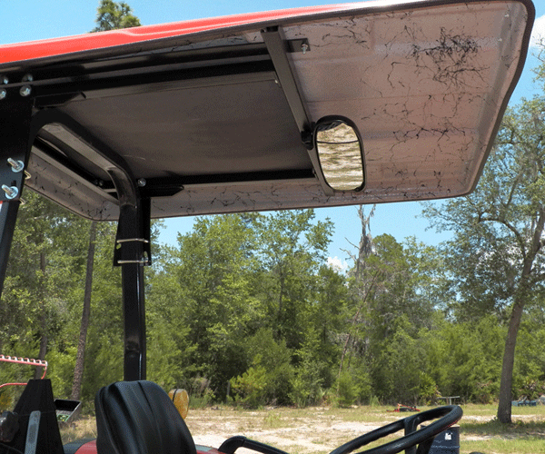

That would be me.. I finally found a mirror that works for my Tractor that I could attach to the roof support. It's a Cipa Extreme Boat Mirror I got today from Walmart online. I did a couple of modifications - Cut one side of the U presure attachment off, repainted where I cut it, added two strips of rubber to help cut down vibration, and bolted it on with washers and lock nuts. Took me less than an hour.
The picture I shot that shows me in the seat was with the Tractor running and I don't see problems with vibration yet. You can also see that you can lock it up and out of the way when needed.

I noticed that the frame for your canopy only extends about half way to the front. Is it stiff enough without the frame?
   / What's that in my mirror?
Thanks Artisan, Creek and Travis.
Yup Gary, the frame on the Kioti is actually longer than the one that came with my FarmTrac, which didn't have a cross-frame, and they appear to be from the same manufacture. I ran around quite a bit yesterday moving stuff in preparation for the storm we may get later today and it is stable as can be. I like that I can adjust the "wings" separately also.
I have a 1.5 mile single lane dirt road to get to my property and try to help keep it drivable for the handful of us who live out here. This lets me see if I'm kickin' dirt into someones face :thumbsup:
