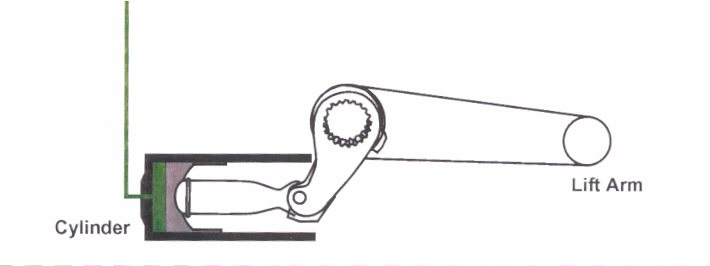

   / What's hard on hydraulic systems? #9
Re: What\'s hard on hydraulic systems?
<font color=blue>As an aside, why is it called a "rockshaft"?</font color=blue>
Cuz that's what it does? /w3tcompact/icons/smile.gif
rock·shaft: A shaft that oscillates or rocks upon its bearings but does not revolve.
Bob, the diagram generalizes how that happens. Here a hydraulically activated piston rod pushes against a "crank" or lever arm thats splined to the "rockshaft" forcing it to partially rotate which causes the attached lift arm to raise.
But you can call it whatever you want. /w3tcompact/icons/wink.gif
DFB
