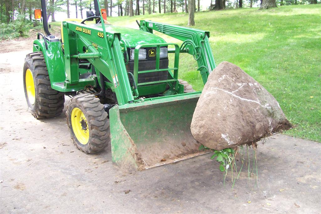

ragkar
This size or larger?
I pick up a little dirt with them, get an edge of the bucket under and lift with a little flip. Just enough to drop the bucket and let the rock roll back into the bucket.
Or, I put the forks on and pick them up that way.
