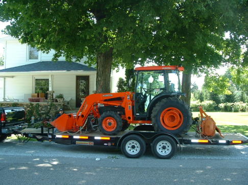

Attached is a picture of how my 4330 fills up a 20' tilt bed. I had an 18' trailer and some implements would hang over the back end. I have found that if you lower the loader bucket and backhoe bucket down onto the deck of the trailer: you will not get nearly as much bouncing action from the tractor. It makes it easier to control and safer because the chains or straps aren't constantly getting yanked. The tilt is super quick to load and unload and you don't have the safety issue of sliding off of a wet ramp.
