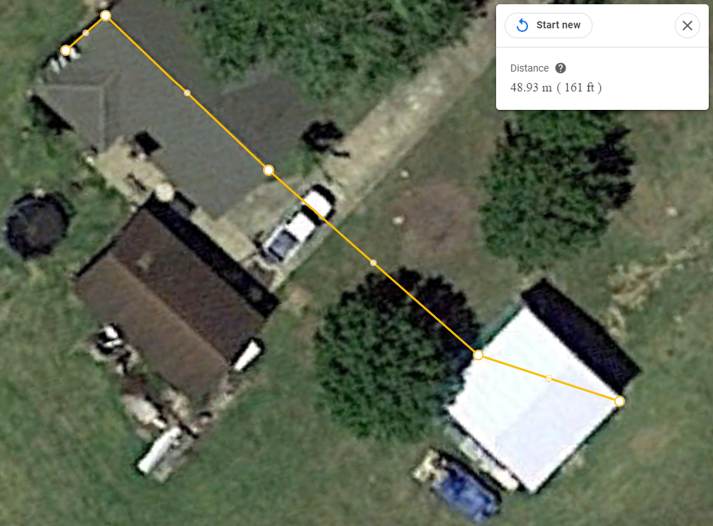

I've set a pole and stretched a carrier wire from my house to my barn in anticipation of running power from the house to the barn. On the same wire I'd like to run an air line from the barn to the house (for convenient tire air in the driveway) and a water line from the house back to the barn for a sink. I thought PEX tubing would be perfect as it's semi-flexible so as to follow the catenary droop but rigid enough not to kink or be choked off by the straps holding it to the carrier wire. But unfortunately I just learned that it's not UV resistant and therefore a bad choice for outdoor use. So what else is there? I suppose I could use plain garden hose for the water but what about the air?

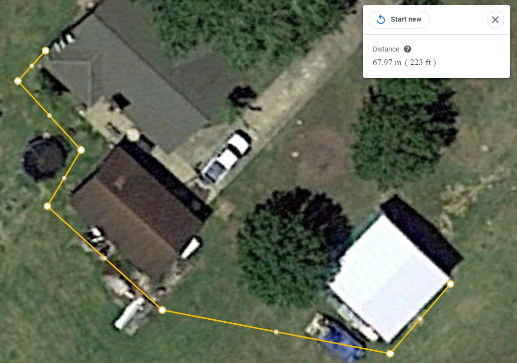

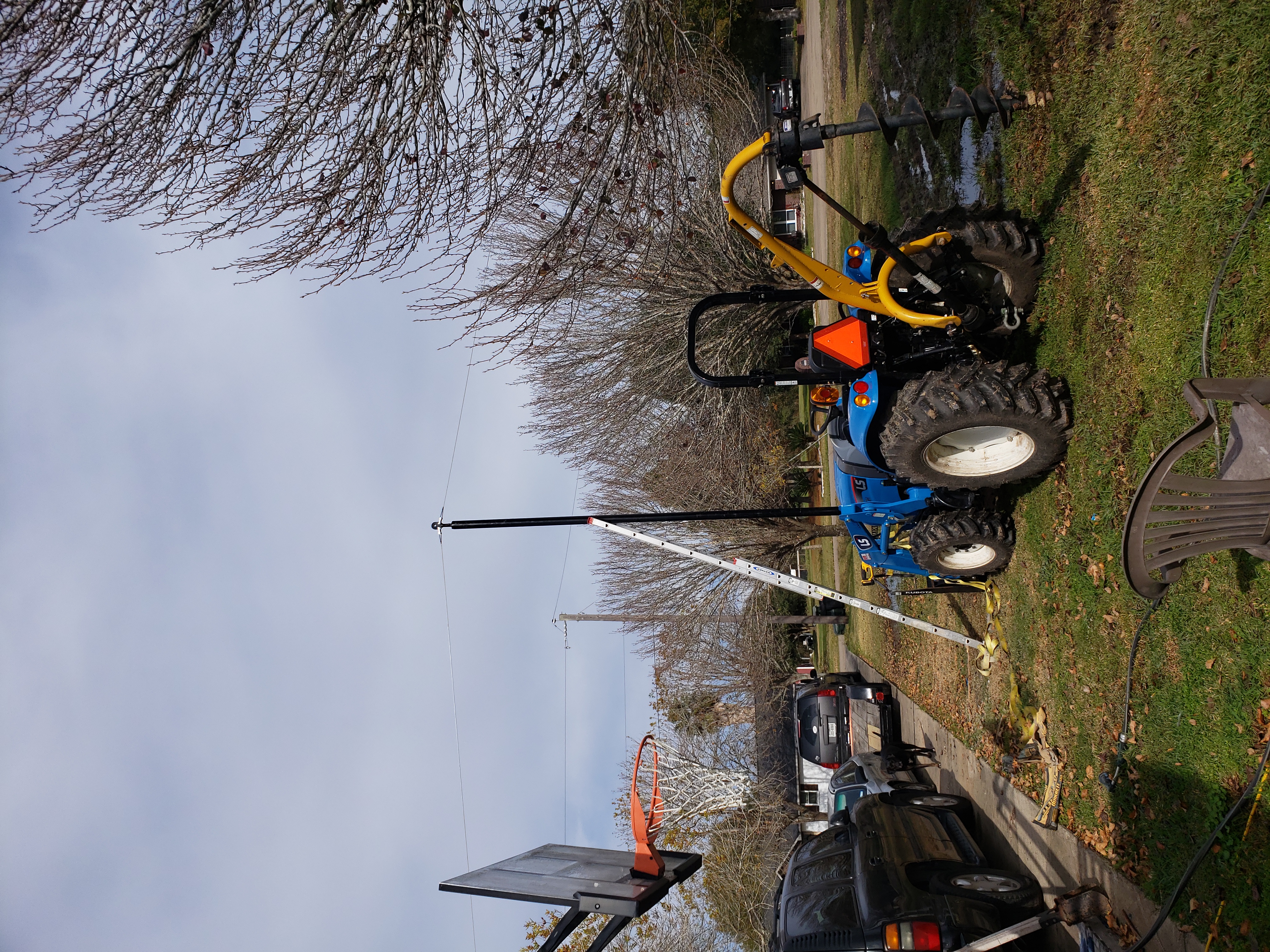

I'm not going under ground because (pictures attached) I would have to trench around my garage and my septic tanks which adds a lot of distance (copper (money)) to the bill. Also I would have to rent a trencher, which would consume a day of man-hours just to go get it, offload, cleanup, onload, and return, not to mention the man-hours spent actually digging that winding trench or the rental fee ...or the risk of hitting my septic lines and incurring more cost. I'll be taking the power off the side of my house, running it through the attic and coming out at the opposite peak (18ft high), over the top of my driveway across a 64ft span with a 22ft high pole in the middle, and down to my barn (14ft high). There will be plenty of room to get vehicles under it.
You can see the sharp bend made by the carrier cable at the top of the pole; Whatever I use has to be able to make that bend and it's not any kind of standard angle that they make a pipe fitting for. Although I suppose any angle is possible with 2 90's and a nipple. The carrier cables are taut right now but I expect there will be some droop once I hang the heavy copper cable off it. That's why I wasn't considering metal (esp copper). This will be blowing in the wind so I don't want it developing cracks from fatigue.
