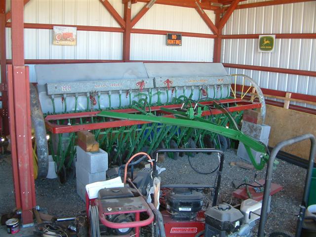

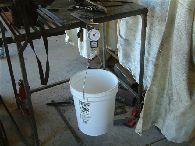

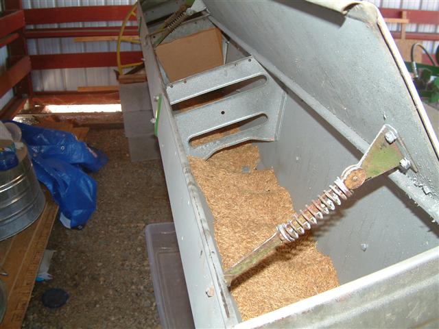

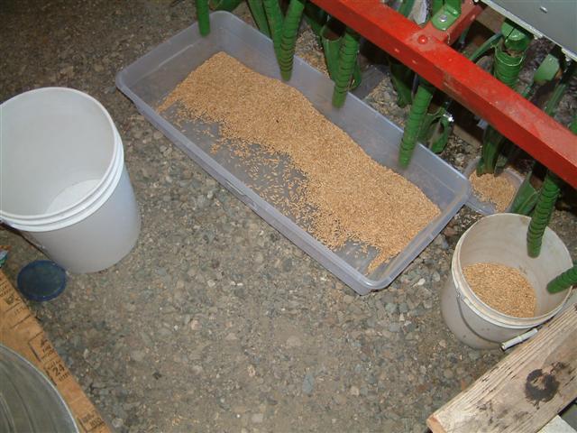

If I were you, I'd jack up that drill and calibrate it with orchardgrass seed. That way you'll know for sure which setting to use.
I did that last month with my old Minneapolis Moline P3-6 drill for oats and fertilizer. I use the large fertilizer box for oats since the grass seed feeders mangle the oat seed pretty good.
