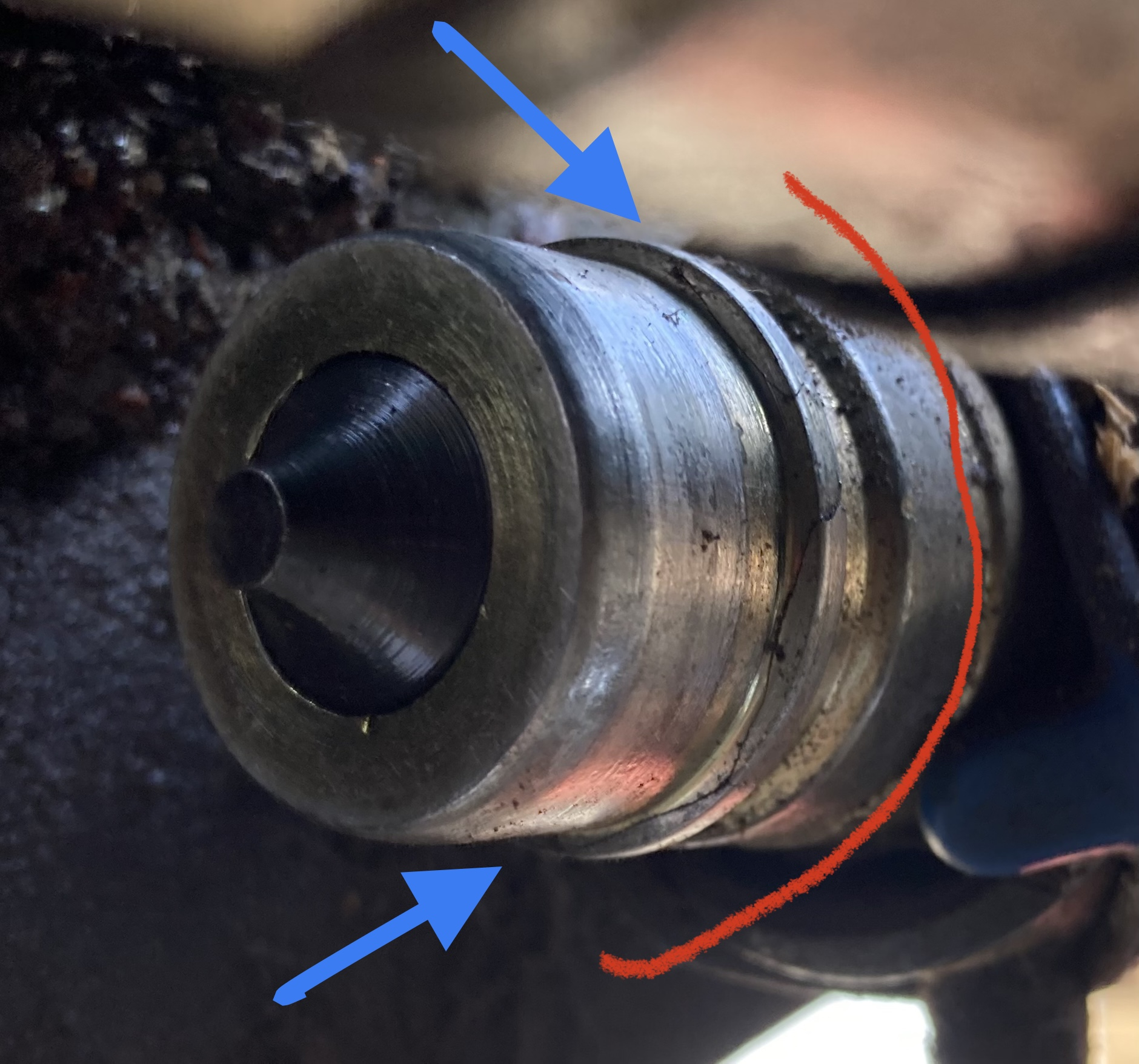

So I was cleaning off my PTO fitting and then I noticed something on the retaining lip;
Yup. That is a fracture line;
It is a very protected area, so I don’t know what to think about the cause.
Any tips for unscrewing these? There isn’t exactly a lot of room in there.

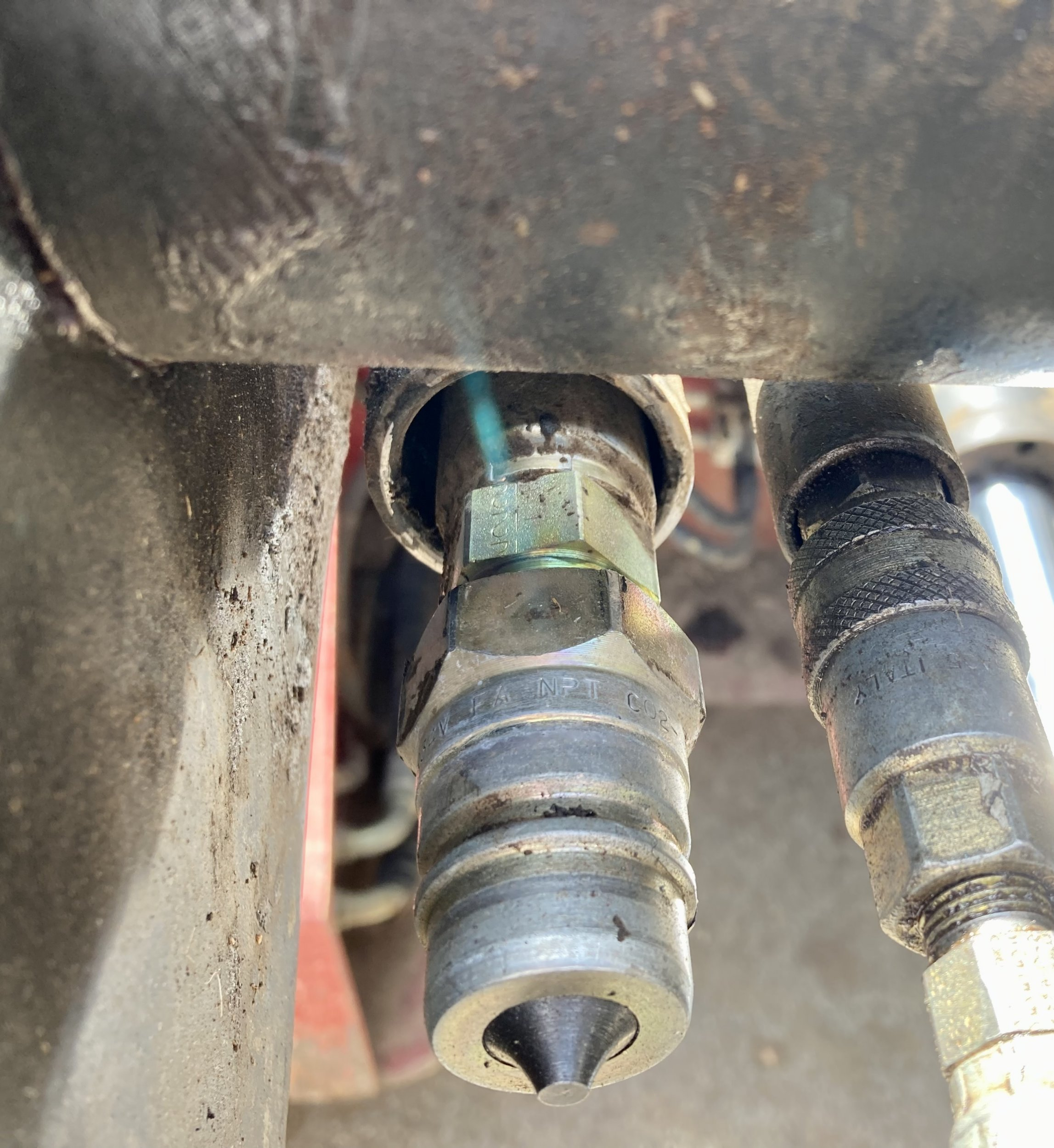

There is a lock nut and a square head bolt that probably goes up from the bottom. Loosen and back off the square head bolt. Then try to feed excess hose into tube and the end of the hose should protrude enough to wrench off the fitting. It might have more slack if you raise the loader up about 3-4'.

As far as the cause, any chance the brand names of the female/male fittings don't match? I would start there even know most people expect that they interchange.

Can you loosen the set screw in the tube and slide the hose and fitting out enough to get wrenches on the fitting?
   / What you don’t know…
Thanks, I did undo the bolt; I can only seem to get about an inch of extension, basically just enough to read the inscription on the coupler. Since there is a cross tube just above the coupler, and the front arm 90 degrees away, there isn't a great deal of elbow/wrench room. I am considering buying a deep well socket that would match, as the the current location looks like a knuckle buster.
I sent photos to Terry, but I haven't heard back from him yet. From the numbers that I can see, it looks to me like it is a Stucchi adapter, which matches everything that I have here at the moment.

What seems weird to me about the fracture is that it is on the outboard side, which is where the metal of the lip should be in compression. Naïvely, I would have expected the fracture on the other side of the lip. The fracture is bad enough now that you can catch the edge on your finger as you run it over the top, about a half a millimeter or so sticks out that is hard to see in the photos.

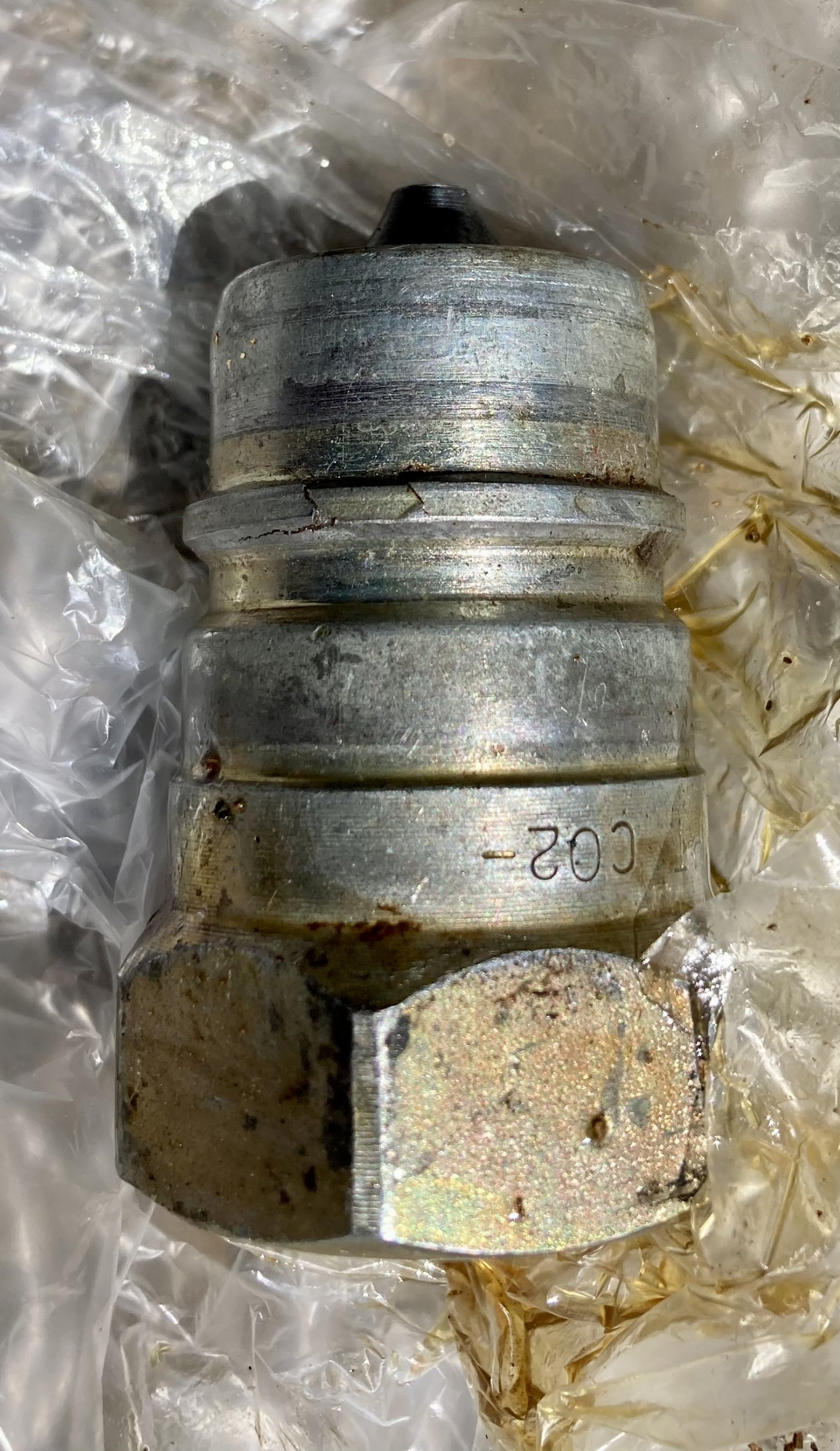

Just to finish this off; I bought a new fitting from Power-Trac and put it on. The old fitting required a monster wrench to loosen, but it came off with just that.

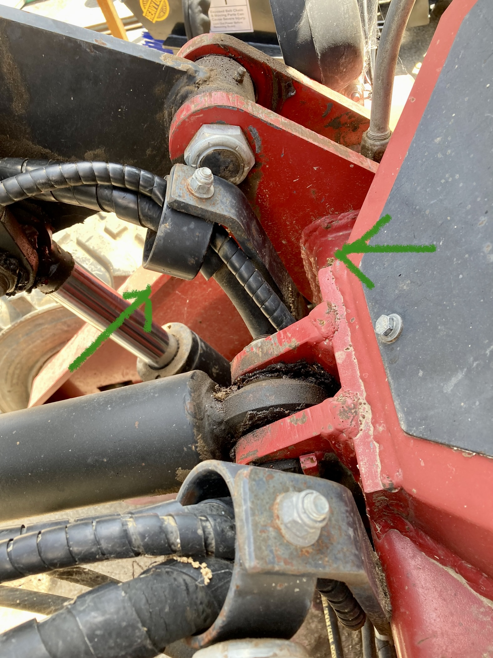

A trick to getting enough hose to work with is loosening the ring bracket that the PTO and QA hoses feed through at the front wall. You can then loosen the set bolt and get 2-3 inches of hose to work with. The swap went quickly and with the FEL arm up at a good working height, no more than half a cup of oil leaked out.

The problem fitting;
The bracket that I loosened;
