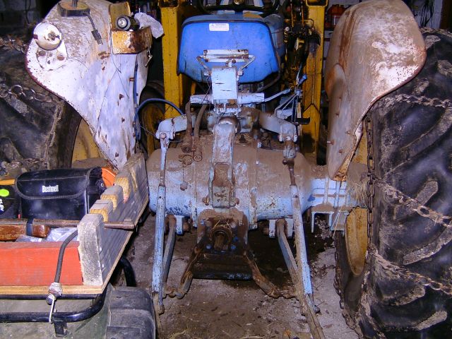

Sheet metal puts it in the '65-3/68 range, as well as the external power steering cylinder which was used until '70 or so. The latest photo clearly shows the single P/S cylinder and rear trumpet housings for planetary final drives and wet brakes that were not used on a 3000 but were present on a 4000 of that vintage. The first photo shows a SelectoSpeed shifter and no air filter cover on the Left side of the hood, meaning it has an oil bath unit in front of the radiator which in turn means it is a diesel. It's a 4000 general purpose, assuming everything is original. The age can be verified given the proper data from the tractor, but it is what it is, and the value is based more on condition than if it has a October 1965 or February 1968 build date.

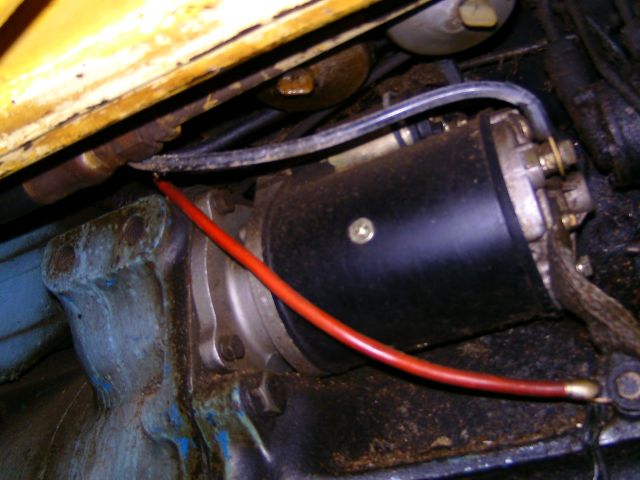

So, based on the pics do you agree that this is a 4000? I just went out in the dark and looked around the starter area for numbers but no luck in the dark and cold. I did snap a few more pics. I'll look some more in the morning and try a little degreaser. Thanks again.

2 things.
as rick said.. with the planetaries.. it's deffinately a 4xxx not a 3xxx.
also.. that pic showing the starter.. to the left you see 2 tapped holes on the bellhousing.. ..on the TOP of that housing where the holes are is where the numbers will be.

Your right, there are numbers on top of that housing of the two holes which was covered up in years of grease. I hit it with brake cleaner but the second coat of paint makes it hard to read. I'm heading up to get some paint stripper.

I'm pretty sure I've got these numbers right. There are 2 lines of them. The first line is 41014E and under that is 0103257. The end of each line is much harder to read so the E might be a B. Because the loader is really blocking this area it's very hard to get in there. I tried the old pencil shadow trick but just couldn't get in there. Since all I want to know is age and model I hope these numbers tell the story.

That Serial Number would be C103257. I could actually have been built in late 1964. See what the 3rd set of number & letter combination is. Those models serial numbers began with 100000 and the first ones were built in mid-1964. They were introduced to dealers at Radio City Music Hall in September, 1964.

Well, I got the good paint remover and I do have 3 rows of numbers The top row is 5-C-3-B and the row under that is 41014E and the bottom row is C103257D. That top row did have the dashes between the digits. Hopefully these numbers will tell what year it is and verify it to be a 4000 model. Thanks all.
