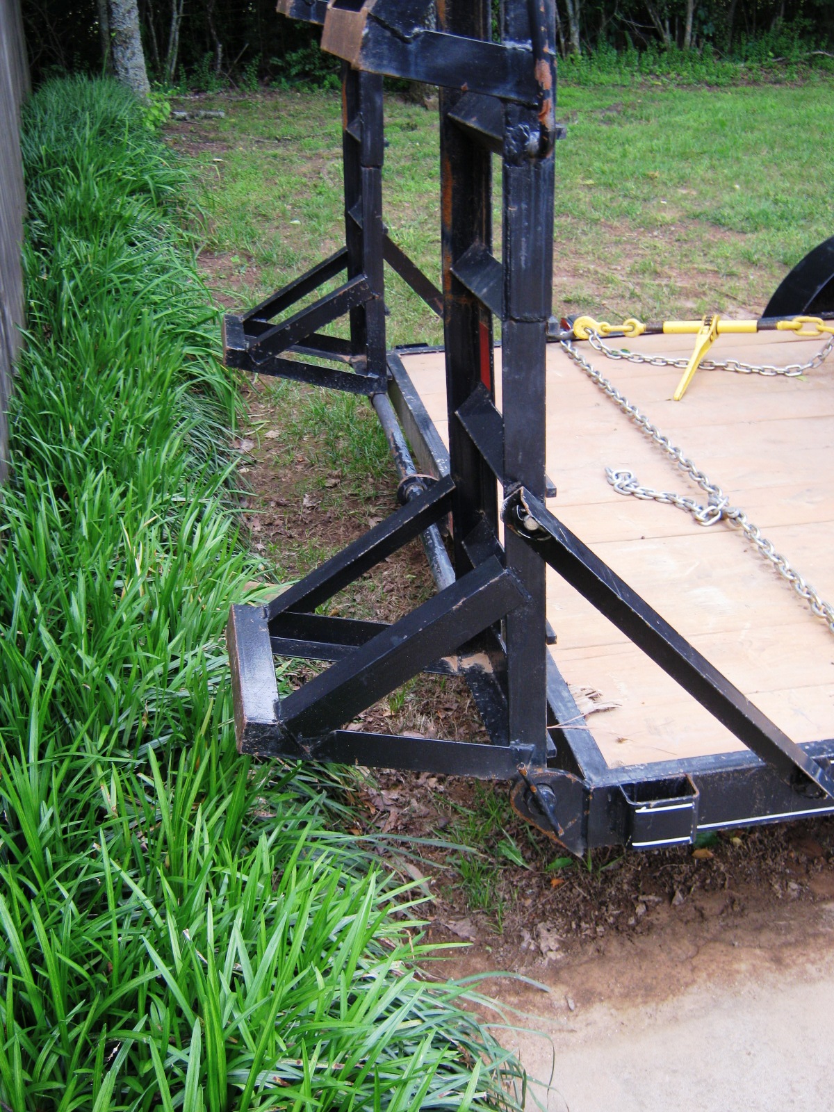

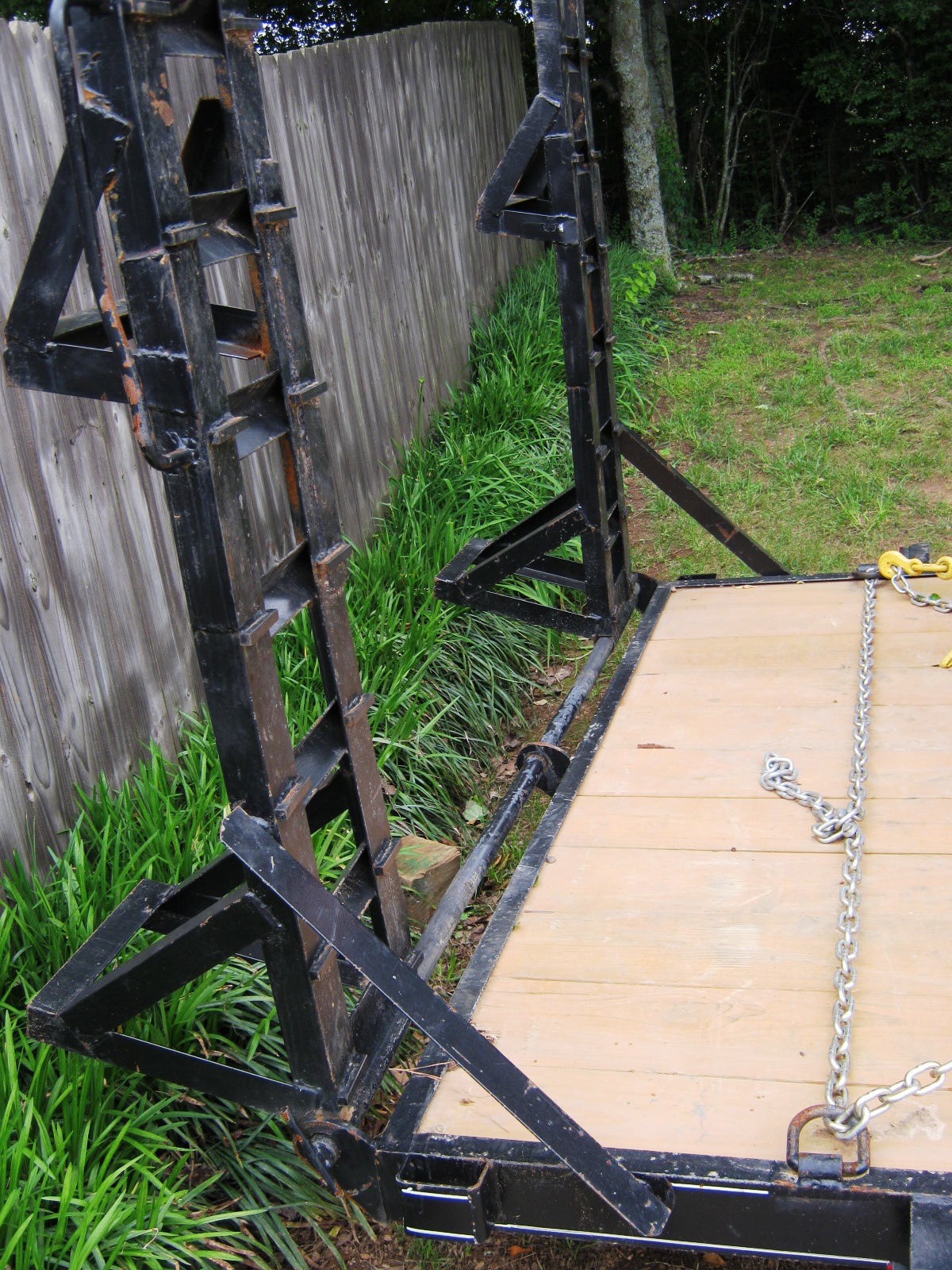

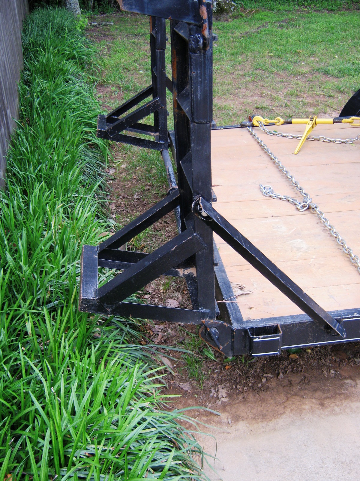

here is some pictures of what I am contemplating,
another thing that I thought about was how the pipe that attached to the crank and goes to the other side of the trailer can also double as something could roll a canvas or some material that could cover when transporting mulch, etc,etc, Just a thought :)

I would make the ramps with legs that support the weight, my current equipment trailer is done this way. It uses a 1.5" diameter bar so the ramps can slide to adjust the spacing. If you load something heavy, you'll most likely want to support the rear of the trailer anyway.

If you do it this way, you can either put a pad eye or a saddle in the middle to help support the bar, this will keep it from bending.:thumbsup:

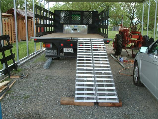

Or use 5-ft long aluminum ramps like these
5,000 lb Per Axle Truck Trailer Ramps
I use the 10-ft long x 16" wide aluminum ramps for my 2004 Isuzu NPR stakebed.

Pictures....
Yes this is how the ramps were connected to the trailer i got them off from,
I've been working on installing them today I have the old bars removed and the new bar installed all the way across with the ramps on the bar and supported in the middle, although is Tack welded on for now so that I might see how they lift and slide from side to side, so far so good and they can slide within 6" of each other giving close enough if ever need to roll hand trucks up them:thumbsup:
I'll more than likely weld them up so they cannot be removed, I'm sure I will regret it later when need to haul something longer and needing to remove the ramps:cool: maybe if ever need be I could simply let it stick out between the 2 ramps;)
