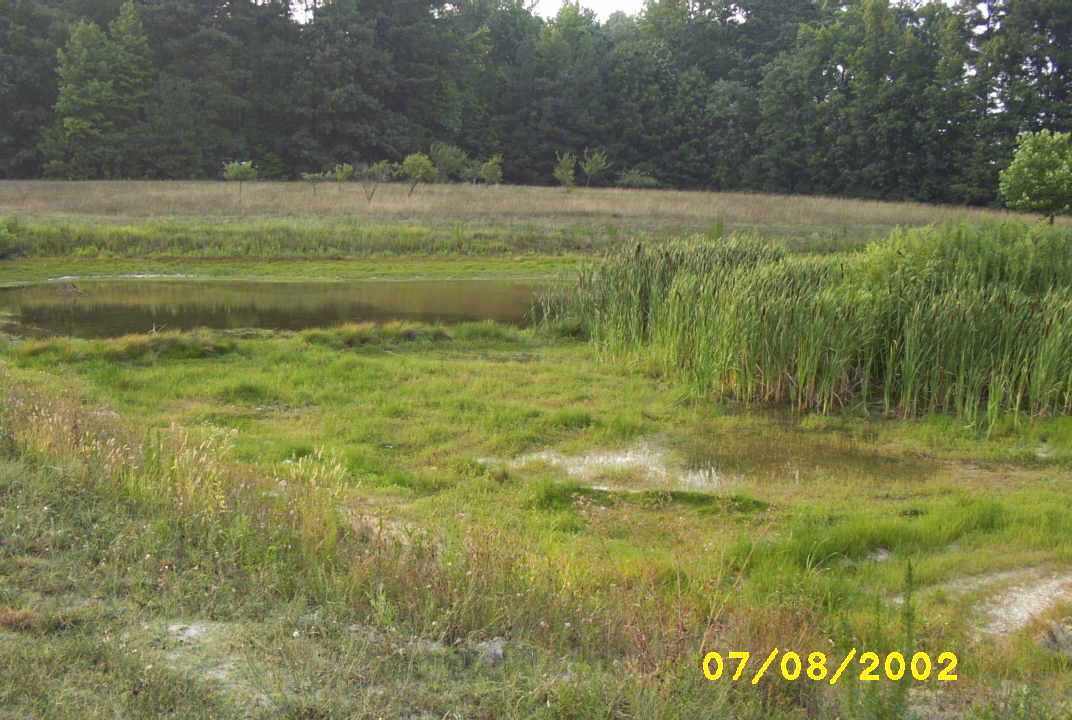

I'm not sure what to do. My pond is quite low. I moved here last June and it has never really been full but we haven't had that much rain either. Its only sourch of water is run-off and hopefully I'll add some since I put drain pipes in from my downspouts and ran them to the pond. I'll attatch a couple of pictures.

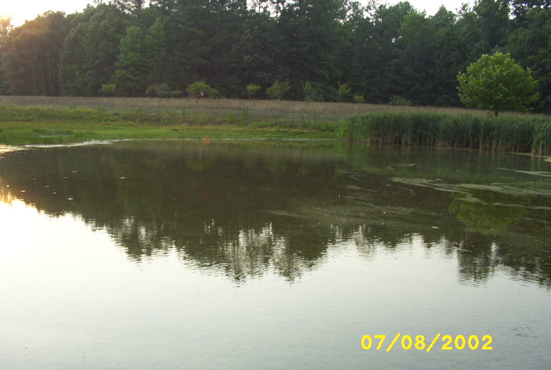

another pic

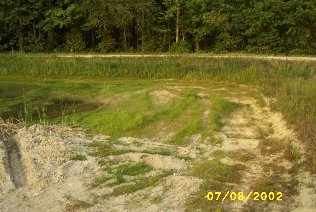

last one. So what options do I have. Do I get some fill dirt and make the pond smaller? As you can see one section fills up decent. Everyones in the area is kind of low but I can't stand it anymore :) 8# bass are still living though :)

I think the first thing to do is to learn more about that piece of land. Is the water table normal of is it a cyclical abnormal dry spell? Why was the pond dug originally or is it natural? If the pond was dug try and find out why it was dug. Around here all the water in small lakes and ponds was about two feet lower last year.

It appears that in photo # 1, that your shallow end bottom is sand. I don't know if this was added to create a beach or if this is the composition of your soil. If it is a natural condition this is why your pond will not fill up. The only cure is to have a contractor dig out the shallow end and pack the bottom with clay or put in a liner. I can't tell how big the pond is by your picture, but if you have 8 lb Bass living in your pond and a good population of Bluegill, I would do nothing and enjoy the pond. You are fortunate, that is a nice looking pond.

The first thing I would do is try to find out from the previous owner or the person who built the pond whether it leaks or not. In our area if they hit caliche while digging the pond it will always have trouble holding water due to leaking through cracks in the rock.
Assuming it will hold water, you should concentrate on diverting all the runoff you can to it. This might involve diverting water that currently bypasses your property, or this pond.

I would wait and see if it fills up after a good rain. The key here is whether or not you have too small of a drainage, or a leak in your pond. If it fills up, and then quickly loses water (say 1 foot every week or two for a couple of months) you obviously have a leak.
Fixing a leaky pond can be expensive. I would contact your local Natural Resource Conservation Specialist (likely listed under Agriculture department in the phone book) to see if they can tell you what soil type you have. Check around to see if other folks are having your same problem. You don't want to fix something that isn't broken.
If you determine it is a leak, I would recommend breaching the dam and digging it out. Hopefully you will find clay and that can be spread out and used to seal the pond. If not, you then generally have two choices, sodium bentonite (a clay) or a liner. Unless you are made of money, a liner for your pond would likely be cost-prohibitive (> $10,000 acre). The sodium bentonite would be less expensive, if you have a local source.
If it is a small leak, you can sometimes fix it by dumping sodium bentonite into the existing pond while it still has water on it. This works best in the cases of a small, focused leak, perhaps at the base of the dam.
