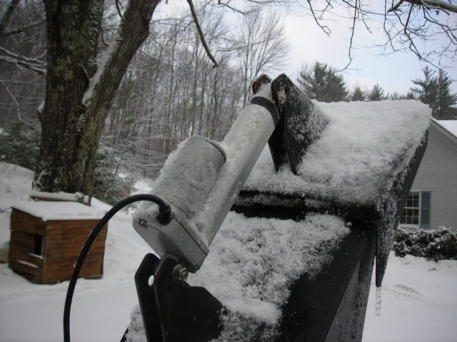

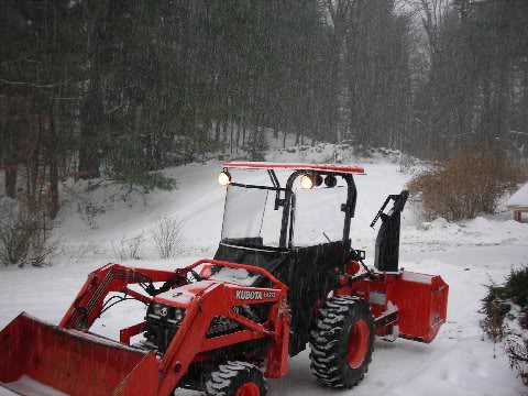

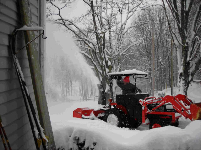

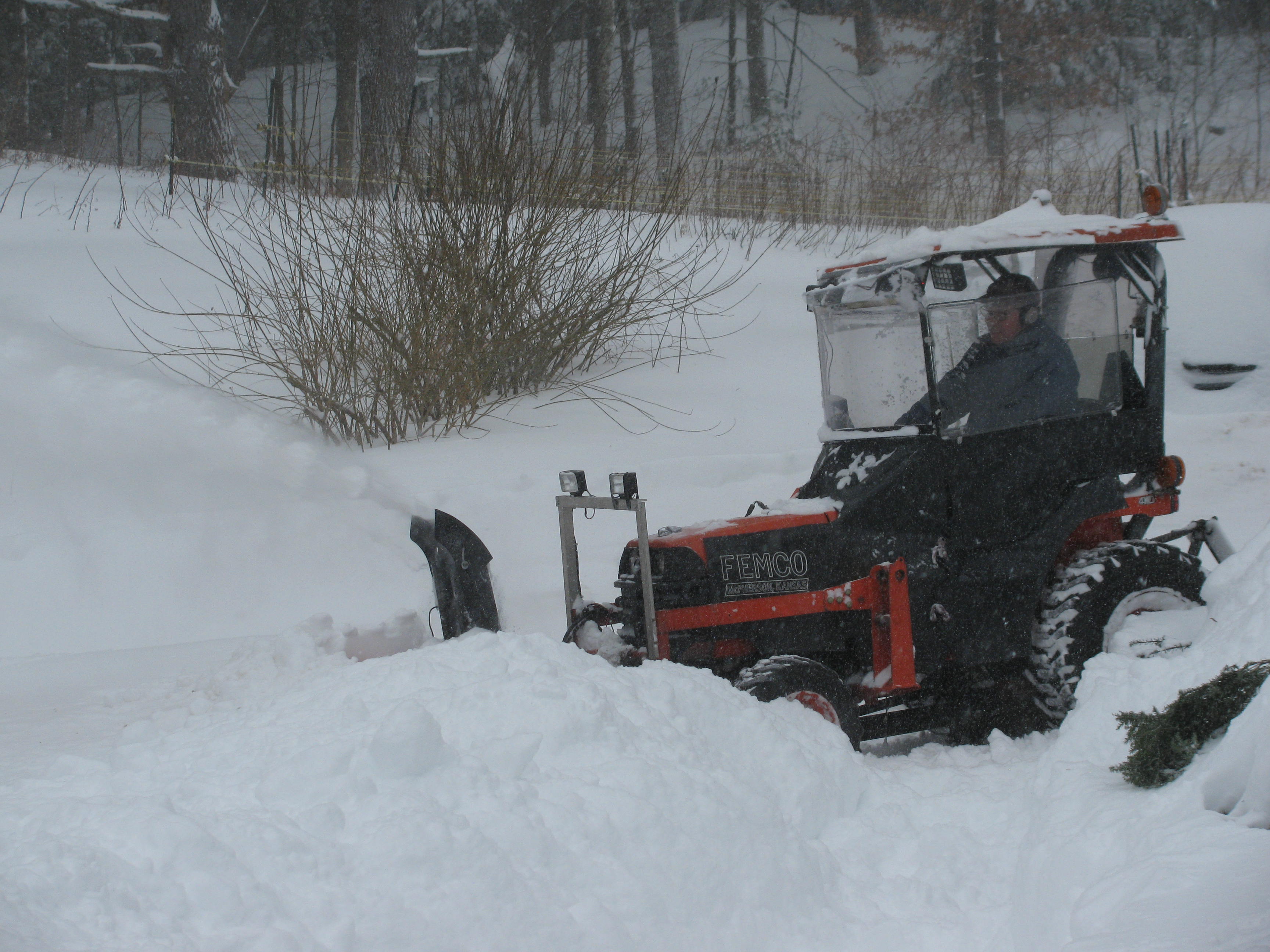

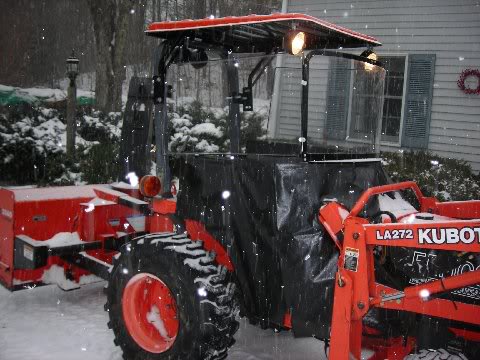

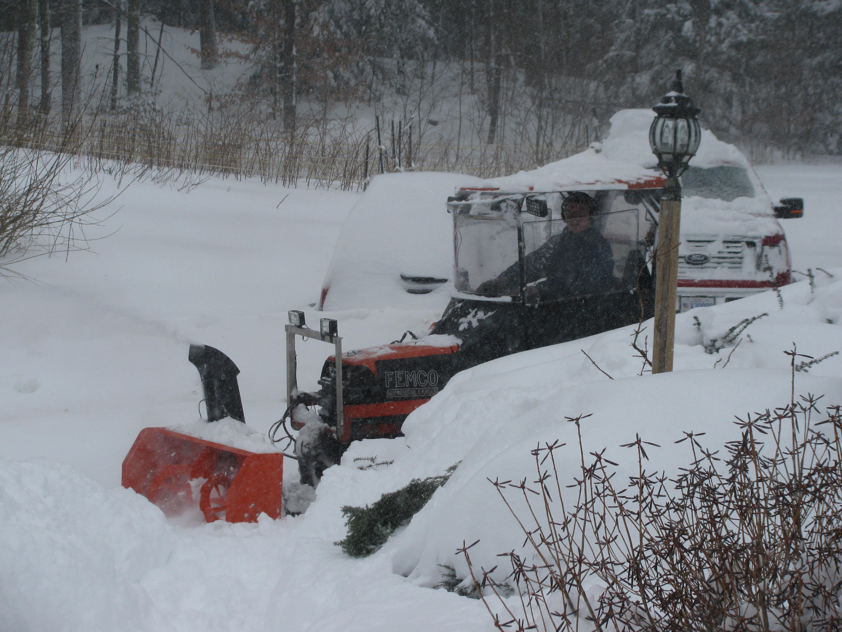

Sounds like a good approach to snow blowing. For a number of years I had a rear blower and I attached plexiglass to the ROPS and that really reduced the amount of blowing snow coming into the driver seat area. I also added a Sunshield type cap and then ordered a Femco weatherbreak which really cut down the amount of blowing snow plus the weatherbreak also directed heat from the motor and made it nicer.
This past year I went ahead and bought a front mount snowblower and quick hitch so I can change over from blower to plow (snow blade) which works better for me. The front snowblower is a little bit faster and less pain in the neck from always looking backwards when I had the three point hitch blower, but the new blower isn’t made as heavy at the old one. sign of the times I guess, pay more and get less.
