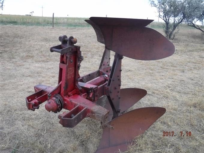

Three point plow:
Note the cross bar the lower arm‘s are attached to. This bar can be rotated to get the proper furrow bottom angle. The lower arms may also have to be adjusted for length so it pulls parallel to centre line .
The bar can also be moved laterally to get right rear tire in the furrow.
