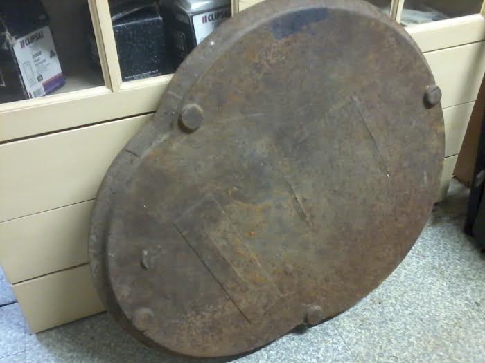

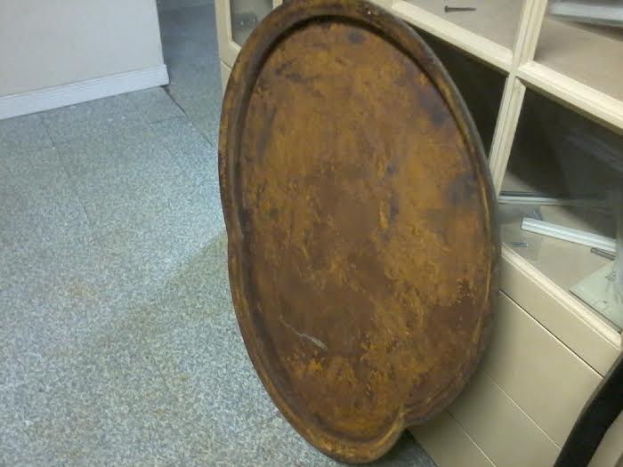

This was a pan that my dad had from the farm 75 years ago. Its cast iron and as the picture with the furnace filter is fairly large. It measures 30inx26in. I don't know what it was used for, any body know?

Looks like it went under a pot-belly stove.

Exactly - TCJatko is right. Its either the very bottom plate on the stove or it set on the floor directly under the stove. The shape and fact its cast iron & the short legs that keep it from direct contact with the floor gave it away. We had a heat dissipating board under our wood stove - it was asbestos-concrete.

I had the exact same one, only also the complete unit.
(Note that there are small 'button feet' in pix 1.)
My unit was double walled cast iron without a bottom but it has 3/4" pipe thread inlet and outlets on the backside.
Also only had a door and no removable top.
It was a hot water heater!---possibly meant to be installed outside or on an earthen floor due to the lack of feet.
The other interesting thing is that there was no means to attach the firebox to the base, it simply sat on the base!
