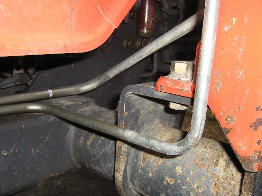

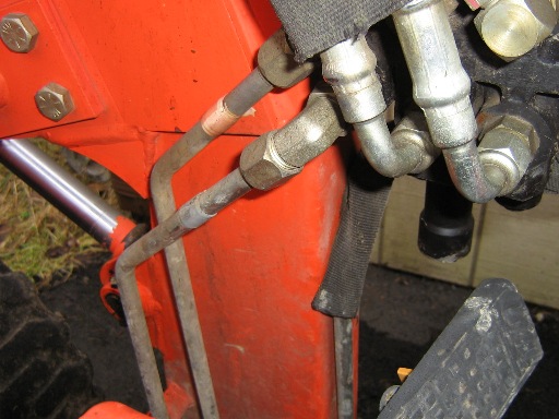

the B21 has a combination of both steel lines and flex hose. the lines that go back to the pump, PB and return enter the valve as steel. I was thinking i could just cut the PB and return lines, tap into them with fittings and at that point convert to flex hose to the new valve.. (I'll get a picture)
I understand now...
Another question came up. If i measure the OD of the steel lines at .5" does that make them 3/8" lines ID? so If I buy 3/8" hose with 3/8" fittings is the ID of the fittings still 3/8"? I am confused about the wall thickness. does 3/8 really measure 1/2" or more OD and what NPT would that be on the valve?
Here is a link that may help: Hydraulic Store They have tubing and also fittings that do not require welding/brazing: Flareless 7000 series, also do a Google search for "swagelok" fittings, they offer both types also.
I would use 3/8" hose for you PB loop to feed the new valve, but 1/4" hoses from the valve to the QD's up front will be adequate. Also, a local hydraulic shop can prove to be invaluable during a project like this-look in the phone book under "hydraulics"

pictures of steel lines
I thought your FEL valve was fed buy hoses?
one picture is the valve. the upper fittings go to the FEL they are hose. the lower lines are steel. The other picture is the lines crossing the frame. This is where i want to cut the lines and weld in the fittings to connect the hoses.
On one post I found here on TBN, another guy had the same problem finding weld on fittings. someone suggested buying compression fittings and not using the nut just push the line into the fitting and weld it. But i am trying to get this figured out before I start cutting up my tractor..
