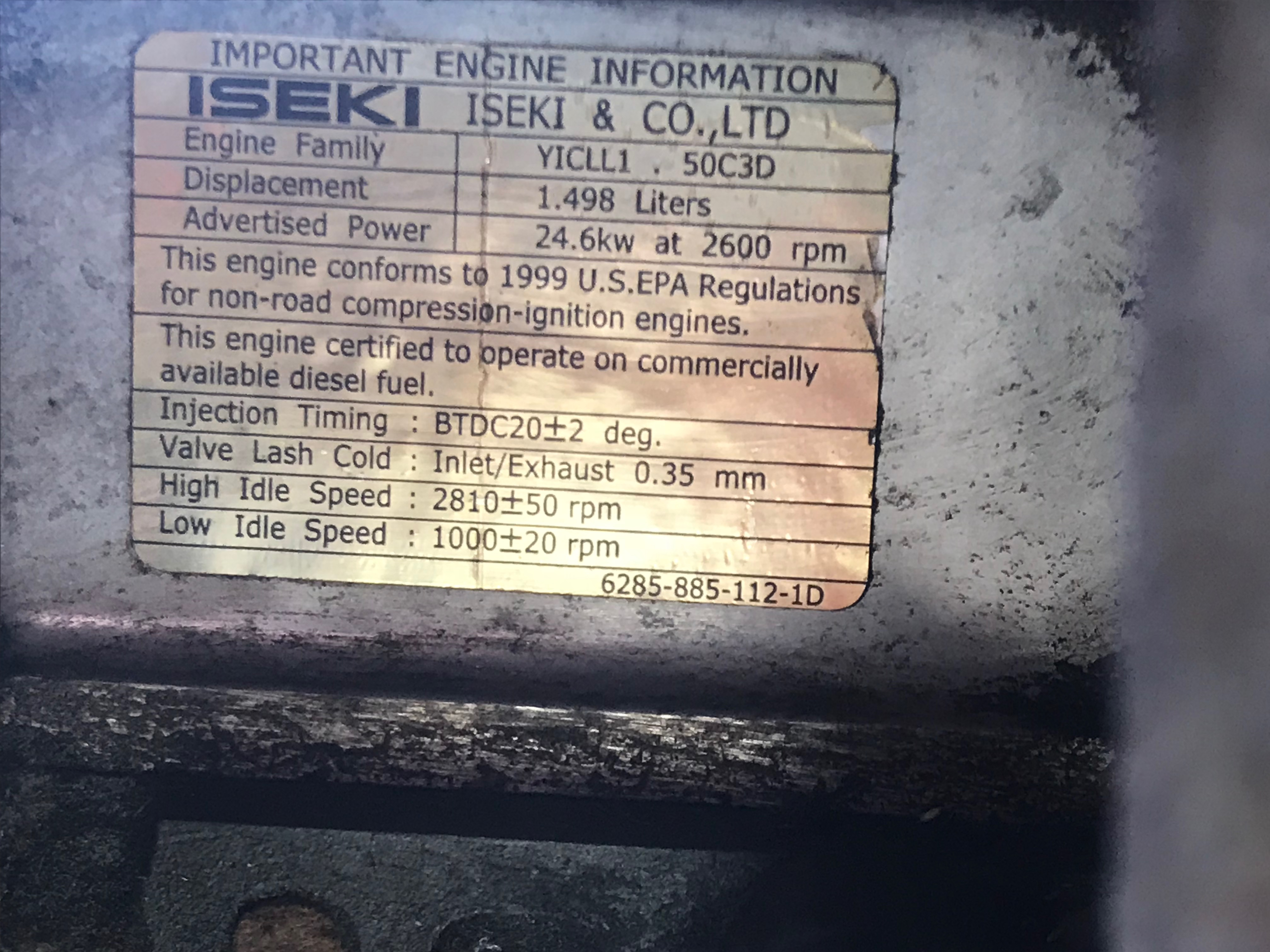

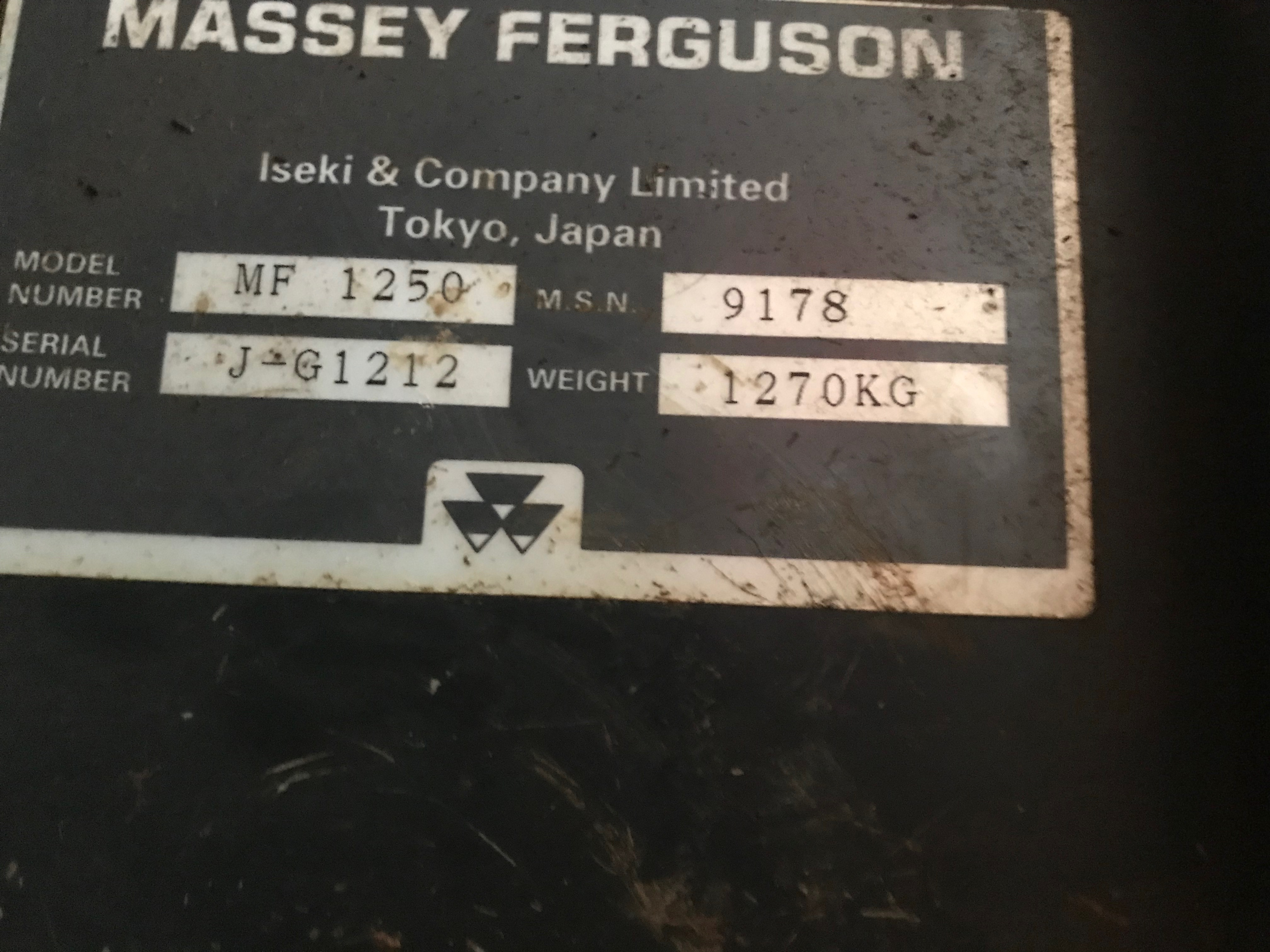

I need to buy an oil filter and I can't read what one is on it at the moment and don't want to undo it until I have the right parts.
Where should I look on the engine to find out what one it is? I see people writing about TK... and TD... How do I know what mine is?
Thank you
   / What type/model of engine do I have in my MF1250 J-G1212 #2
most likely is an engine tag somewhere on the engine itself
   / What type/model of engine do I have in my MF1250 J-G1212 #3
It's an Iseki engine made by Iseki, the actual tractor manufacturer and sold as a Massey Ferguson 1250. the first picture tells you the motor model number.
Thank you found it. 🚜
