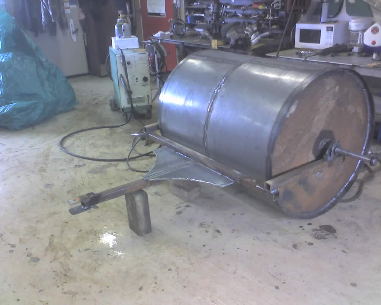

Sometimes its for cost savings, and sometimes it because what I want isn't on the market. And a lot of the cost savings depends on what I already have in my scrap steel pile.
An example of not having what is needed on the market is the lawn roller that dad and I built just a few months ago. The biggest that we could buy was a 24" by 4ft wide for about $250. He already has one, borrowed from a neighbor, but they arent heavy enough. We tend to drive in the yard when it's a little soft and rut it up, which was no big deal with a little mower, but with a fast ZTR, it beats you up. Also, the thin material of the rollers dent easily if you have to cross the drive.
We had all the steel for the ends, and the toung, and 1 1/2" pillow block bearings, so all we had to do was buy the 1/8" steel to be rolled and a 1 1/2" round bar for the axle. Steel comes in 10ft lengths so we just got a full 4 x 10 sheet rolled which makes it 38" diameter. With no water it weighs about 600lbs, and can hold about 1850lbs of water. It works better than expected. We did have about $350 in it though, but better than $250 for a roller that wouldn't do what we wanted.

Thats a nice looking roller there LD1 as well as the trailors quite the load You you have on them . :D

Thanks for the complement.
We definatally aren't afraid to use them. The bigger of the two is only a few years old and has probabally hauled about 40cord of wood. The next trailer will be a dump for sure:D
