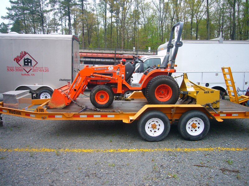

my sig -
go bigger

My 25 HP tractor with a FEK and any implement on the rear is 16' long. I have a 18' trailer and it can be tough to balance the load.
I would measure your rig then add at a minimum of 2'. I think you are going to find you will need a 20 or longer trailer.
