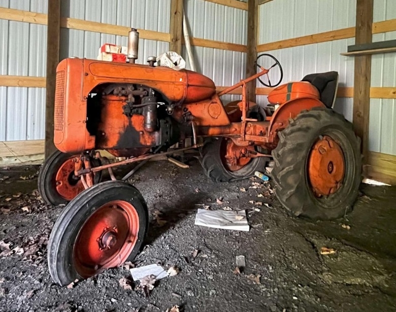

I believe this is a dated Allis Chalmers tractor. If so, an anyone identify the model and year?
   / What tractor is this? Allis Chalmers? #3
Yes it’s a B

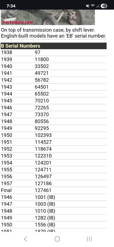

Serial number on trans top case, use for year id
   / What tractor is this? Allis Chalmers? #4
Maybe tractordata.com can help.
It's included with a property thats FS and just wanted to know it's appropriate value if we sold it. Thanks guys!
   / What tractor is this? Allis Chalmers? #7
Around here, not a lot. They were very common and a lot built. In this area it seems everyone had a 2n/8n/9n or a A-C B
   / What tractor is this? Allis Chalmers? #8
I buy CA's which where improved with 4 speed trans versus the B's 3 speed and the CA's have power adjust rear rims and I can buy them in nice running and looking shape for $2500 Canadian all day long just for you to reference.
