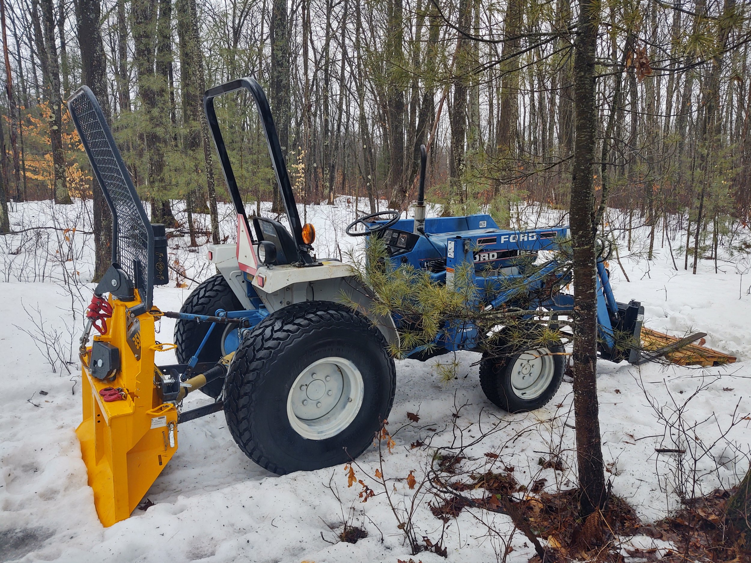

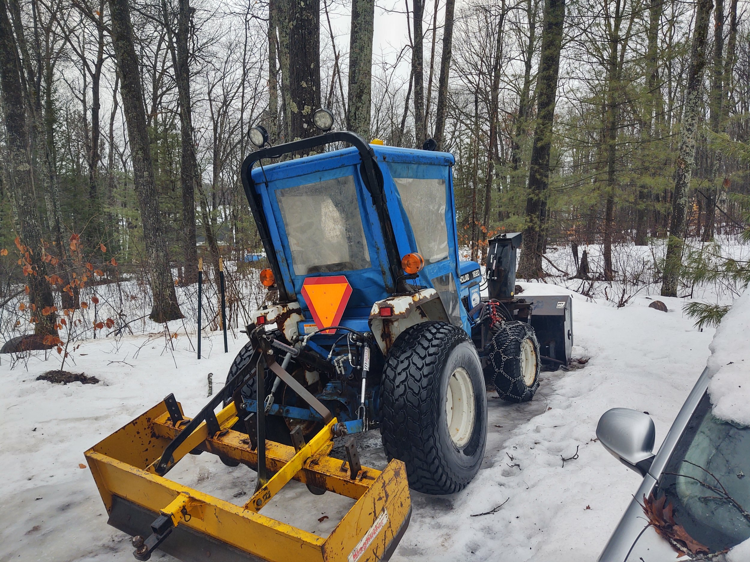

Hey guys, through a series of fortunate events over the last 5 years, I've ended up with two tractors for very good deals and I'm thinking it might be a perfect opportunity to sell them both and upgrade to one larger/slightly newer unit.
The two tractors I have are both mid 90s new hollands. The first is a 500 hour 1620 with soft cab and factory front mount blower that I added a turbo and hydraulic top/side links to. The other is an 800 hour open station 1520 with the factory loader that I converted to skid steer quick attach. They've both been fantastic and have served well. But, only 1200lbs of lifting capacity is quite limited for handling logs. That's the main reason for considering selling the pair for a larger tractor.

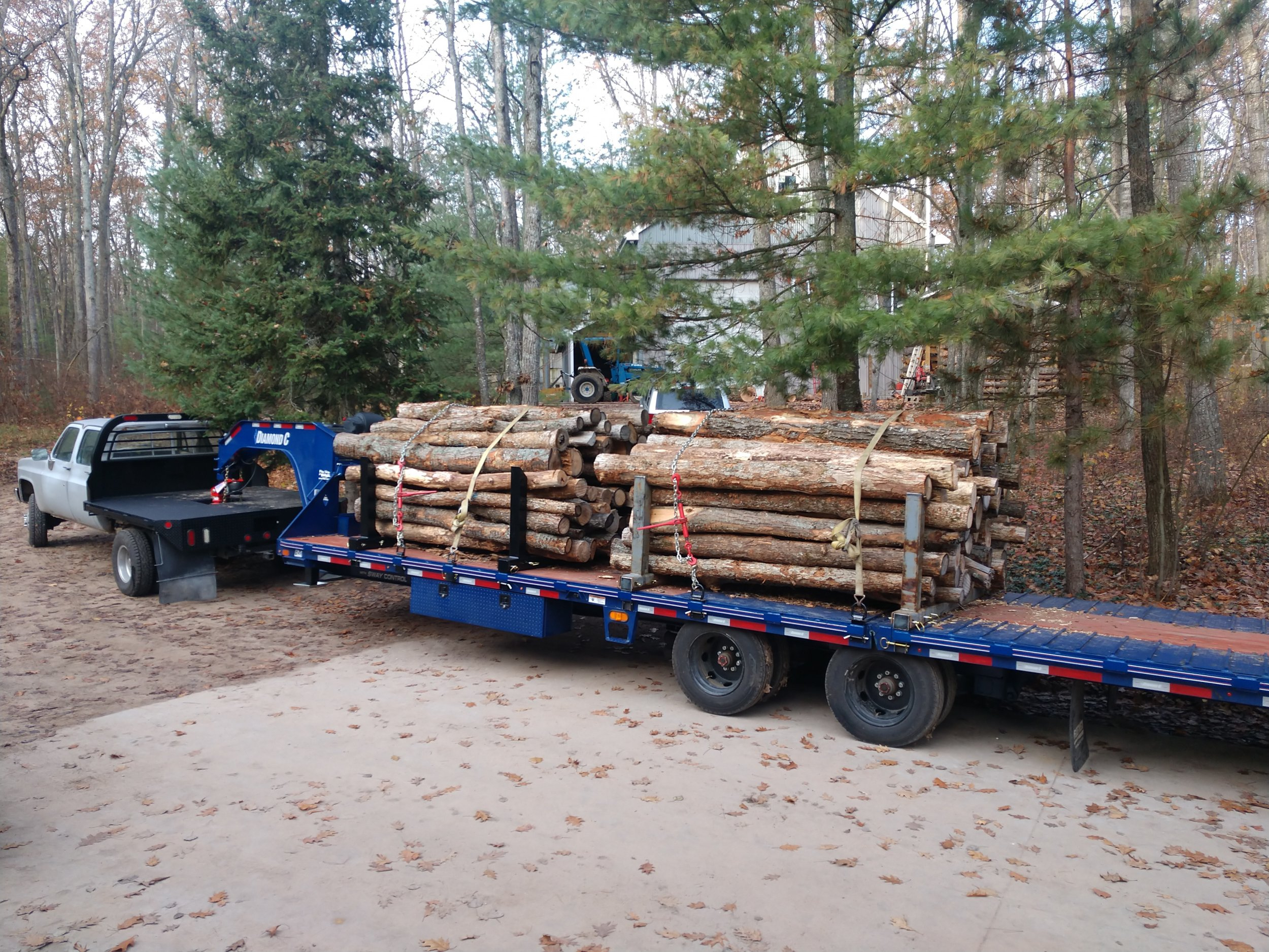

The tractor will only ever grade driveways, snow blow driveways, run a skidding winch, run a pto chipper, load/unload logs from the gooseneck, load/unload pallets of freight shipments from semi's, and basically be an off road fork lift. I'm not 100% opposed to buying a brand new tractor, but I'd prefer to purchase a used unit for the obvious cost reasons if one can be found with the features I'm after.
So that brings me to the main question at hand, does anyone know of a particular tractor that has all the following features? Or am I chasing unicorns?
-Smallest overall size with the most HP/loader capacity. I absolutely love the size/maneuverability of the 1520/1620. Neighbor has a NH2120 and it's significantly more cumbersome for woods use.
-35-45hp
-4x4 and mechanically controlled hydrostatic transmission. Don't need/want the fancy features I've seen Kioti tout with their electronic hydrostats.
-Direct injection engine. IDI diesels always run hotter at full load and start harder in sub zero temps. I know basically any brand new tractor will have a DPF. Does anyone get still get away with only a DOC? I believe Mahindra was for a while...?
-Mid pto and available factory front mount blower. I'm not backing up for the five different 1/4-1/2 mile long and hilly driveways I maintain.
-Quick attach loader with 1600+lbs lift capacity
-Hard cab with heater
-Needs to fit through a 94" tall door opening if possible
-High mounted fuel tank. A low hanging plastic one is begging to get punctured out in the woods. Can always build a skid plate, but would be easier not to have to.
-Non electronic rear PTO engagement. My pto chipper has a 200lb flywheel and it is much nicer to gently engage it vs slamming it on.
-Needs to be under 12' long from the front bumper to the end of skidding winch to fit on the dovetail of the trailer with the log bunks on. I set the loader forks on top of the second bunks of logs currently, and it works perfectly.
Thank you in advance everyone!
