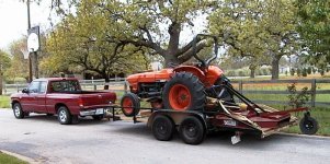

I regularly tow my L345 and 5' cutter behind a 1996 B4000 with the towing package. It's only about 5 miles from my in-laws place (where I keep the tractor) up to our property, all on county roads. There's a pretty steep climb involved, but the 4.0 V6 handles it fine.
