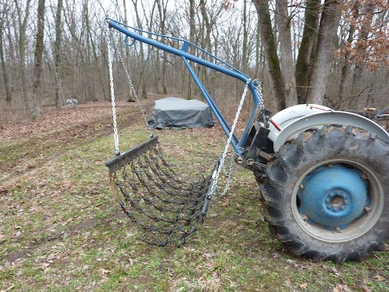

If you have a chain harrow or a drag-type spike-tooth harrow, try it. If it works, then buy a boom pole. Drag the harrow with the tractor drawbar, and the mounted boom pole loosely fastened to the harrow, and lift it with the boom pole to empty.
Photo found on the internet
