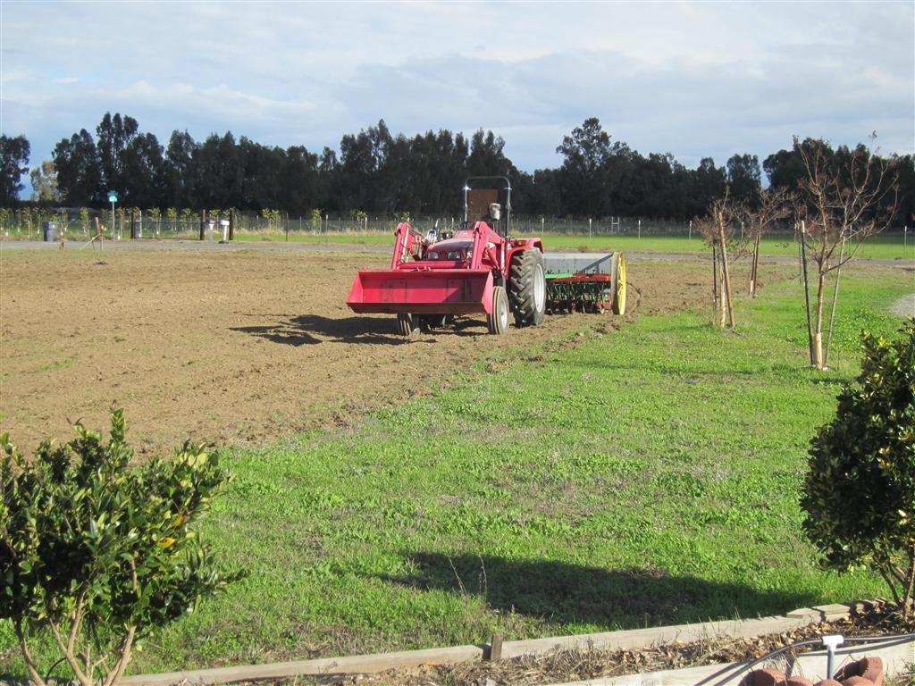

Hello again, Im kinda new to all this but id like to know if i can simply use chains behind my IH model 10 grain drill to cover up the seeds. We will be planting a mixture of hay, brome and other small seeds (for our horses) and i want to make sure im doing things right.

A chain harrow will work just fine. I'd also recommend ballast-rolling the paddocks after that in order to set/compact the ground... it'll allow the roots to get more of a grip due to horses 'ripping' at the yummy grass.

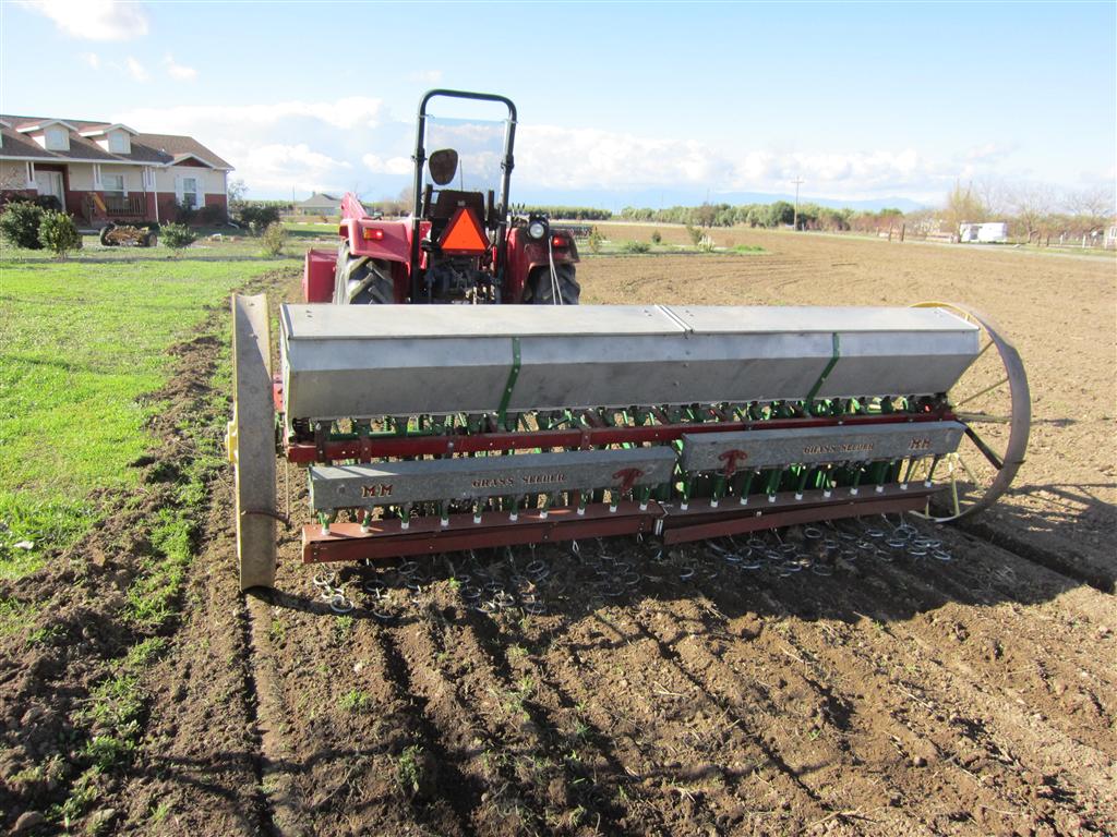

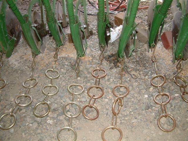

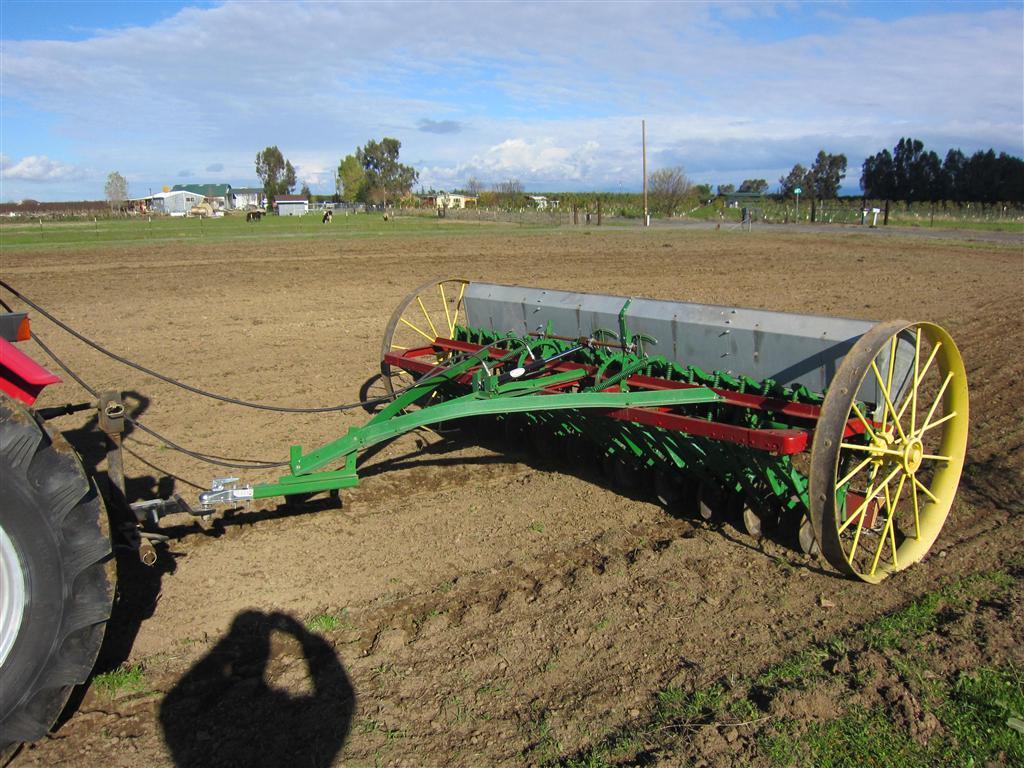

I use drag chains from these guys on my old, restored Minneapolis Moline P3-6 grain drill
http://farmpartsonline.com/grain-drill/grain-drill-drag-chains/

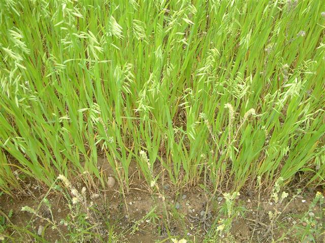

These chains do a good job. Here's Kanota oats I planted a few years ago before the drought hit CA

That doesn't look right. There is no way that tractor should be pulling that drill - they aren't even from the same century.
I would have used my 1964 MF135 diesel, but it doesn't have the rear hydraulics for the drill.
My 1951 Minneapolis Moline BF was in parts when those photos were taken.
So I just used what I had available to get the crop planted.

Flusher,
That drill is a very nice looking piece of machinery.
