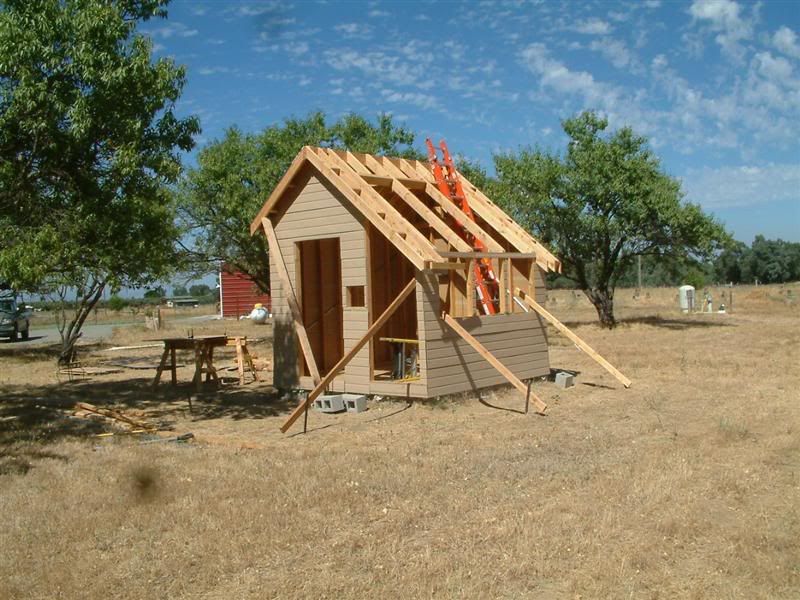

I use an 2 gal air compressor and a 6-in-1 framing nail gun both from Harbor Freight and both about $90 each. Around my 10-acre place so far I've built three 120 sf saltbox sheds using these tools with no problem.
Potting shed:
Sunshed (greenhouse):
Observatory:
Not the world's best framing job, but a lot of fun. Tools used for framing: hammer, nailer/compressor, 7-1/2" circular saw, Black & Decker Navigator reciprocating saw, steel tape, spirit level, C-clamps, step ladder.
