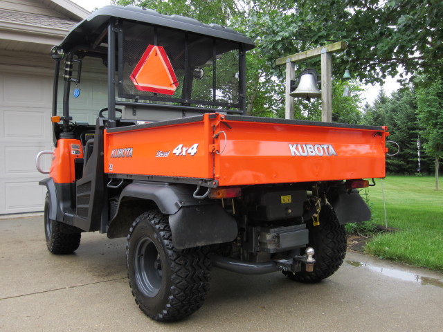

The 2006 RTV900 I traded to the dealer was in VERY good shape and they had it sold before it came off the truck. Things you can look for: loose rear axle nuts that wear the spline out, worn rear u-joints, the hydro seems soft or weak like a clutch is slipping, evidence that all the adjustments (lots) on the engine/trans has been messed with, does the shifting of the levers feel solid or is it iffy that maybe worn shift forks.
