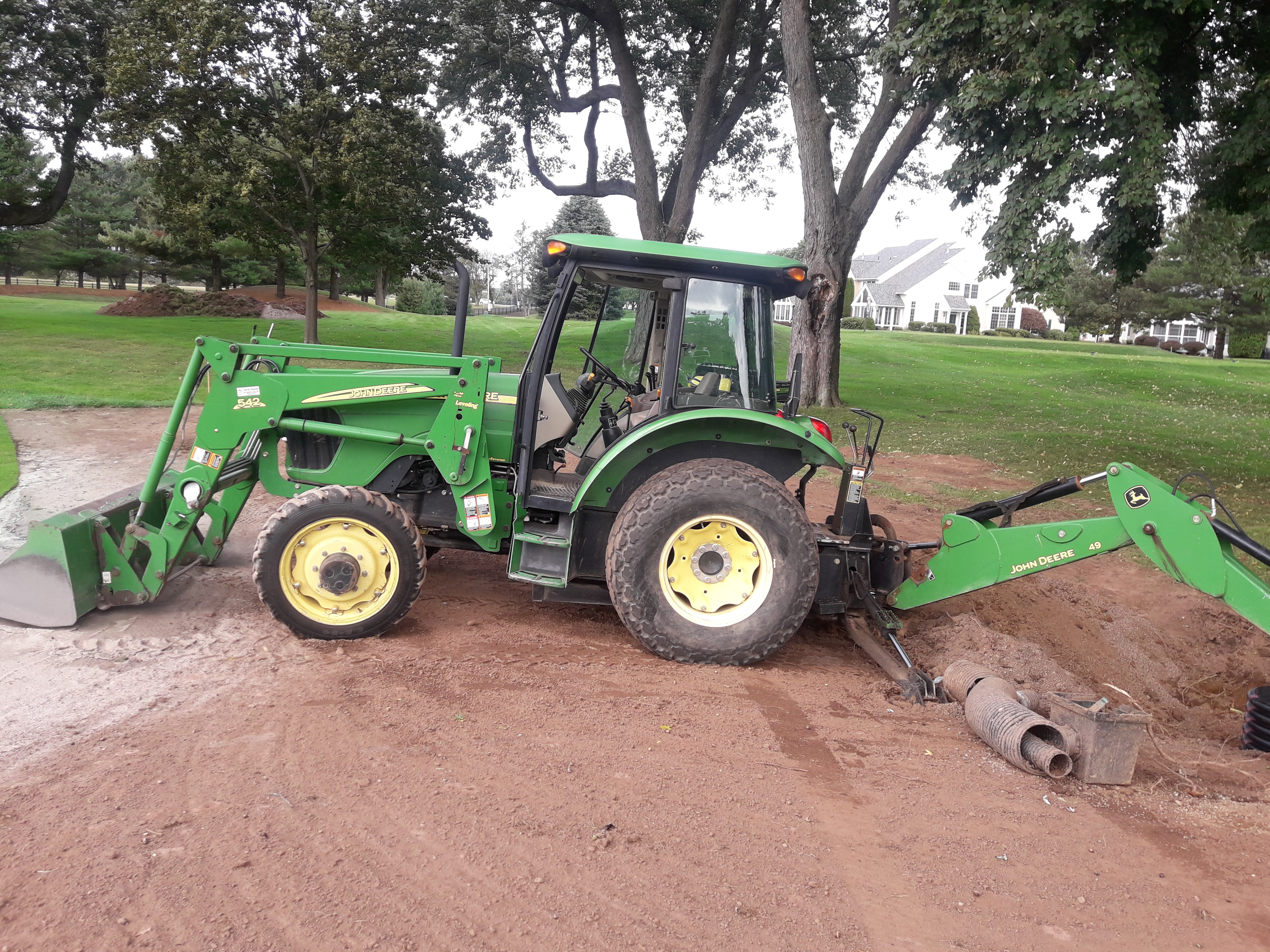

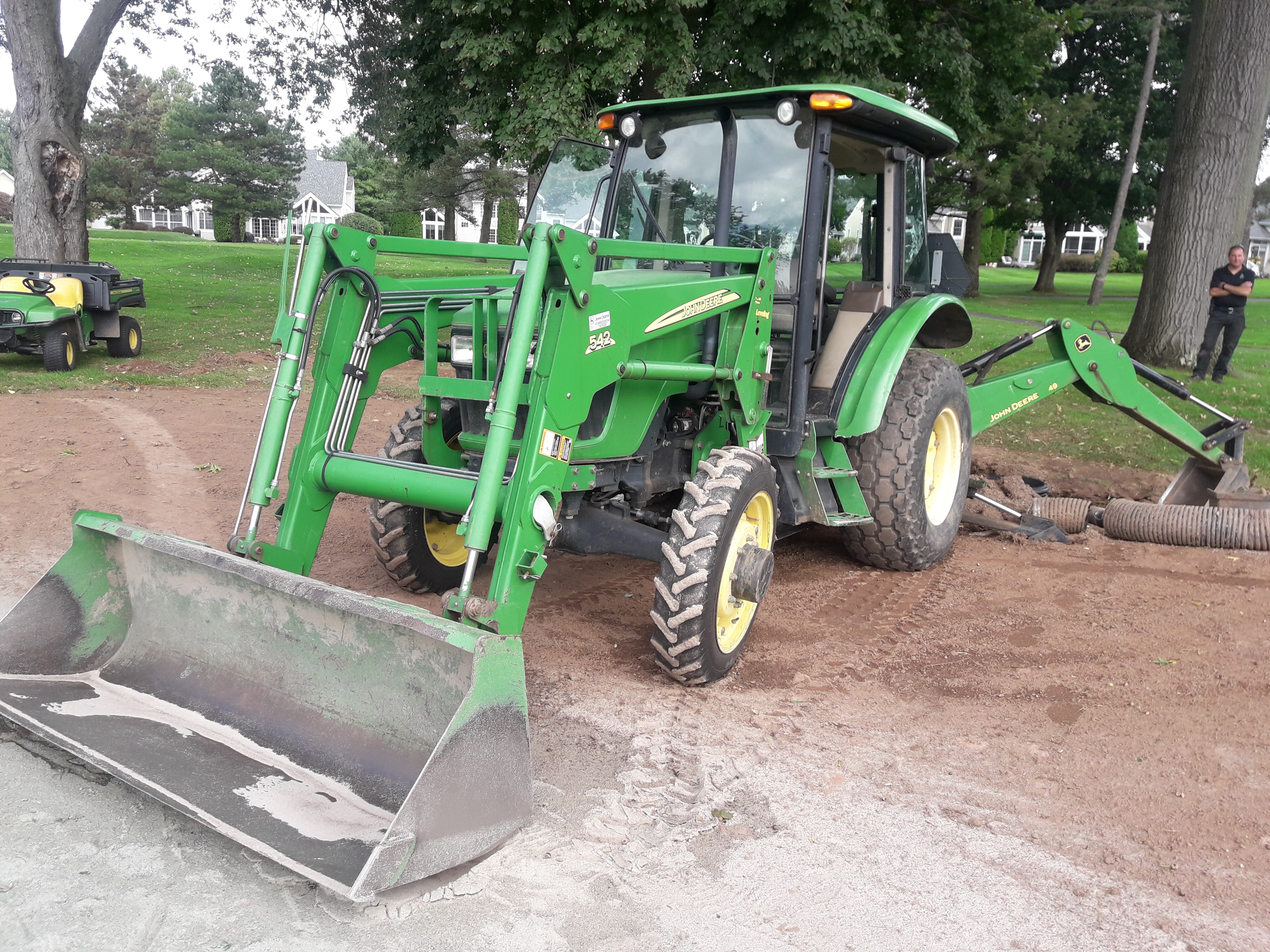

   / What to look for J-D-5325
So the tractor is a 2007. It has about 2150 hrs. Runs good, shifts good. Has the A-B-C range with shuttle shift. Has a J-D 49 backhoe attachment and a 542 loader. Full cab. Loader and backhoe work well. That electric PTO thing it does have that.
The bad
Something is up with the 3 point hitch, I didnt get the whole story but something broke (a case I was told and it was fixed) and then it was all removed and disconnected so it would not happen again. No arms on tractor, I do not know if they are still in the shop or are just gone. I need more info on this. Not sure what exactly broke?
Missing cab door. I heard the glass got broken. Dont know if it is still around or not.
No real maintenance records
Bucket has some wear from materials, slight bend on top, backhoe has wear only where it attaches with the pin for transport. Looks like it got bent and someone heated it back up and bent it back. Not a big deal, worked fine
The tilt steering sometimes locks and sometimes does not.
The edge of the back fenders has some small breaks
Needs ag tires. The turf ones are OK and somewhat worn, but I will need ag use tires.
There is a small leak in the rear end by the top link. May not be serious but it is wet around that area.

View attachment 622597View attachment 622598
Find out exactly what was done to the 3pt and what parts they have.
What size are the tires, front and rear. The rears are not the low pro, super low and wide ones. You may not need wheels?
Leak might upper lift arm seal?
Sounds like it's not the PowerReverser, Most likely SyncroShift, but could be Collar Shift.

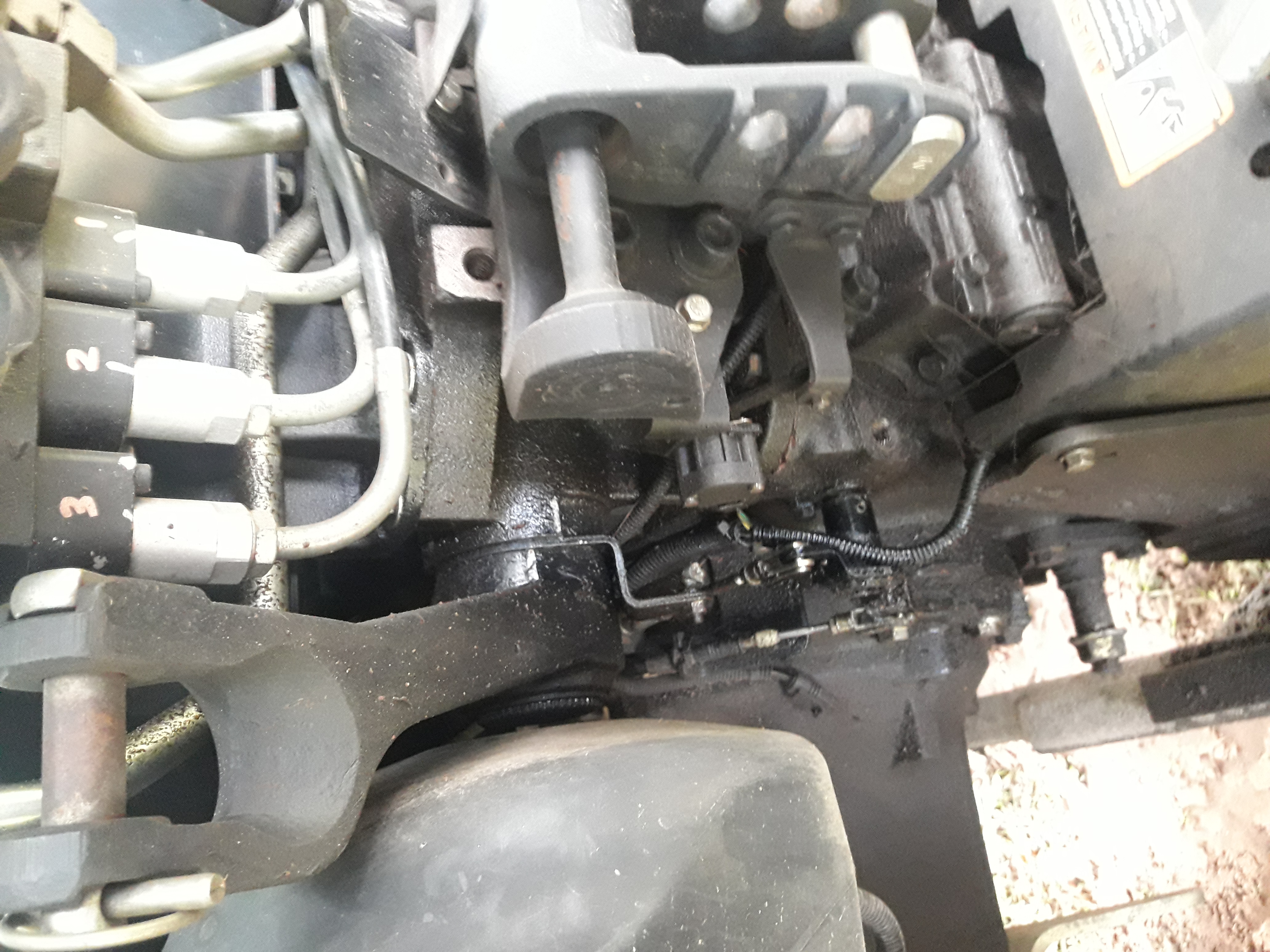

I drove the tractor and it drove, ran and shifted fine, It has the lever on the left side of the steering column so I guess it is Power Reverser. So just to clarify, Put the gear range say in B, shift into gear say 3 then you can move forward and reverse without using the clutch?
The loader has a hydraulic connection under the cab on the right side if you are sitting in the tractor. I have a pic of this. I missed how many couplers were on the rear. Just out of my picture.
You might be correct on the lift arm seal, especially if someone has been in there dong something with the 3 point arms.

If it has the PowerReverser (sounds like it does) move the lever (while going forward) back towards you (any gear, no need to clutch) and the tractor will reverse. I would NOT reverse at high forward speeds. Reverse will be slightly faster than forward, just the way the mechanics work.
It sounds like it's well optioned and worth considering. Factor in repairs, missing parts (if any from the 3pt hitch), possibly rear wheels, and all fluids and filters changed.
Check rear tire size, see if AG comes in that size. Fronts look worn too. Common on mfwd
3pt light might be the lift arms are out of normal range, they looked too high in your picture, but hard to tell for sure.
