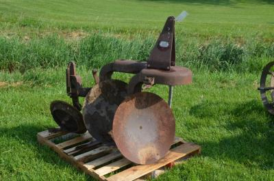

I am looking at 2-bottom plows for preparing some new ground. I've tried many methods, but trying to get through years of old CRP is a chore, so it seems flipping it may be the easiest method. I assume a two-bottom is plenty for an MX5200, and I don't know if the plow size make a huge difference or not. Most people don't even state it on the ad. It won't see a ton of use so I can't justify anything new here.
What is good price range? Are there any issues I should be looking at to see if it is broken or may soon need something replaced? I assume parts aren't that easy to come by on these older units, but may be wrong given some of the brands are still around.
Moldboard plowing usually works well unless there are stumps or large roots, in which case it will hang up. They handle rocks well unless it's a really huge boulder that is big enough to trip the bottom or stop the tractor. I've turned over plenty of softball to basketball sized rocks with a moldboard plow. I can't say anything about disc plows as I've never used one nor known anybody who had.
The plow size makes a big difference in how well a tractor can pull it. The amount of draft required to pull a plow is based on how much soil the bottom moves. A wider bottom will move more soil along its width, but it also generally runs deeper too, as a plow depth is generally half the bottom width. Ballpark is that it takes close to twice as much power to pull a 16" bottom than a 12" bottom. 2 bottom plows are usually 12" or 14" bottoms but a few are 16s. You should have enough power to pull any of those in about any soil, if you have any problems it would be wheel slip depending on what tires you have and how much ballast you have. If your soil is not clay, you have ag tires, a gear transmission, plenty of ballast, your plow has coulters and good sharp shins and shares, you might be able to use a 3-14 but to be honest sticking with a 2 bottom would be the safest option.
A typical price on a 2 bottom plow is usually in the $200-400 range if it's in the typical old, rusty, and with worn shins and shares but complete and not broken condition. If it's a pretty new one it might be closer to a grand as a new one is $1200-1500 or so, several places still make and sell new one and two-bottom plows for food plots and such. Look to see if anything is obviously bent or cracked, or missing. Plows are generally pretty durable so it's generally just wear parts needing replaced unless somebody put a Grade 8 shear bolt in a shear bolt bottom or has a trip bottom rust up, hooks it up to a much more powerful than required tractor, and then hooks a stump with the plow and bends or breaks something. Wear parts vary in how easy they are to get, the older the plow the harder they are to get, you can generally get shins and shares for most bottoms made since about the late '50s/early '60s if they were made by a major maker. Any structural part is going to be difficult to get though, unless you got one of the new ones that's still being made.
