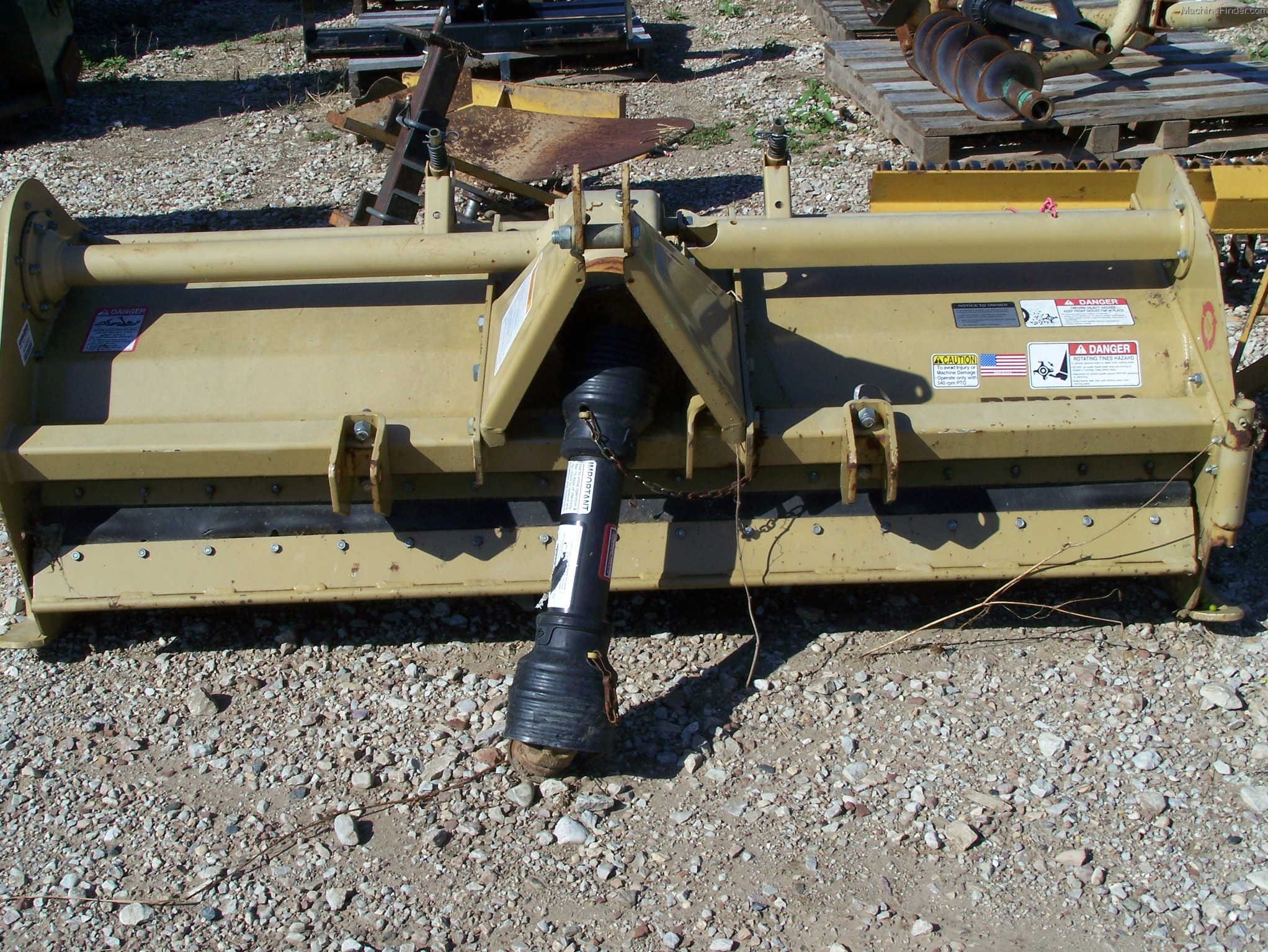

I'm going to look at a used Landpride RTR2570 tiller at a local dealer. Asking price is $2000. Not sure how old it is, or how much use it may have.
Can anyone tell me how to identify how old it may be?
Any suggestions on areas to look for that might indicate a sign of problems and therefore maybe passing on this unit?
Lastly, what would be a fair and realistic offer to make, assuming the tiller is in good shape?

Gear or chain drive is an option, with gear drive in the higher dollars.
I picked up a used 60" (for $500) that is chain drive, and had to fix an oil leak due to sloppy work done previously. Another thing to look at is the condition of the tines (teeth, knives, whatever). If they are worn, broken, or missing figure close to $10 a tooth. I only had to replace 6 teeth, and the rest are in very good shape. Indication that the tiller had minimal use IMO.

The RTR 25 series has 6 tines per flange but it is a reverse rotation tiller. Are you aware of that and is that what you want? It is a chain drive unit. Gear drive is better, longer lasting...IMHO. Does the PTO shaft have a slip clutch? Have you used a tiller like this before? If you haven't, it may be worth renting one or two to try them before you spend $2K if you have rentals around you???

In my opinion don't buy a reverse rotation tiller. As far as quality goes, a tiller isn't an implement you want to cheap out on. With a 3320 your best bet is a John Deere 665 tiller. It is commercial duty, standard rotation, 6 tines per flange, and heavy enough to not bounce on compacted soil.
I use mine for commercial use and have hit concrete chunks, rebar, roots, 4x4 posts, car parts, ect... and have never broken or bent a thing.
As far as looking for problems on a used unit, check for:
1. Sharp blades- still at there full length
2. Leaks from side case
3. Bent or dinged rear gate (from hitting hard objets)
4. Solid U-joints on driveshaft and tiller assembly
a. lift tiller off the ground and turn the driveshaft by hand. If there is excessive play before the tines start moving you will have problems down the road.
b. Shake the tines themselves to make sure the axle bearings are tight

gkh - yes I'm aware this is a reverse rotation tiller. Having spent a fair amount of time searching and researching posts here, I have weighed the pro's and con's of both reverse and forward rotation. I'm leaning toward the reverse rotation, but not "dead set" on one. Haven't seen the tiller yet, but slip clutch is supposed to be standard on it.
DDT - Thanks for sharing your experiences with the RTA2570.
Tractor Guy - 665 and 655 have both been included in my searches. Nothing close to me except new, and that's way out of my budget. Thanks for the great check list!:thumbsup:
If the RTR2570 is in good shape, I would like to consider making an offer on it. It's listed at $2000, but I think they'll deal, since it is used. What would be a fair and realistic offer?
I found a pic, which I'll try to post...
Thanks again to all.
-John
