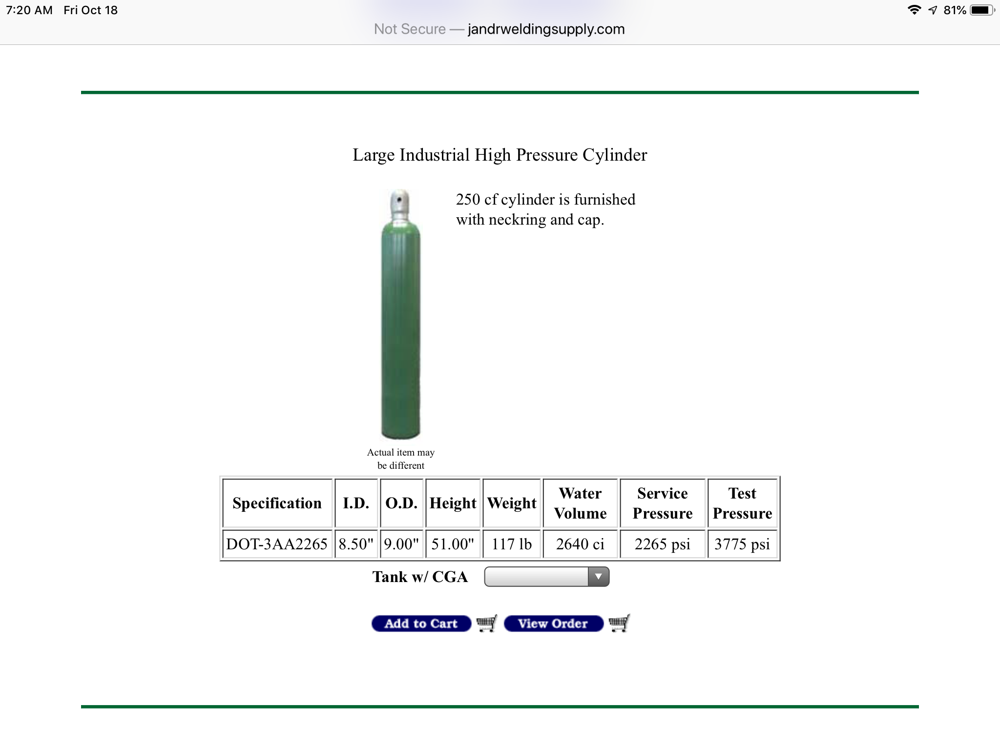

Let me help you understand what is being discussed. The tank volume is about 11.5 gallons.
