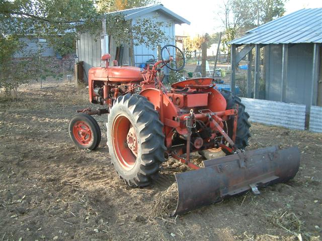

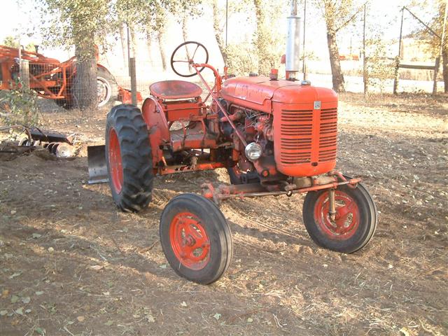

Probaly can get you an old 8N or something like that for that money!!Maybe even get a old shredder with it.
There not going to be able to do everything but you can hirer the stuff out that you couldnt do.But its a start!!!
