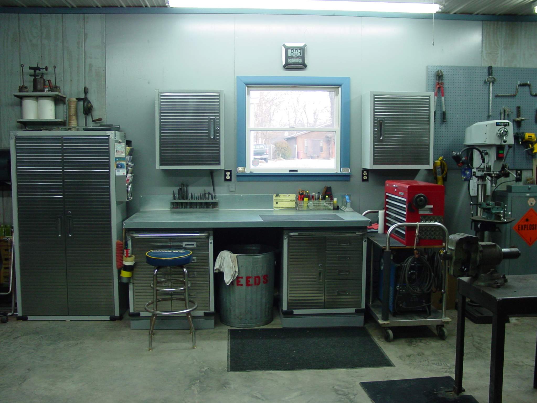

   / What to buy for my workshop. #8
I have been waiting to share this find. I found these cabinets at Sam's Club. They are what I have been looking for. I thought someone else might like them.
