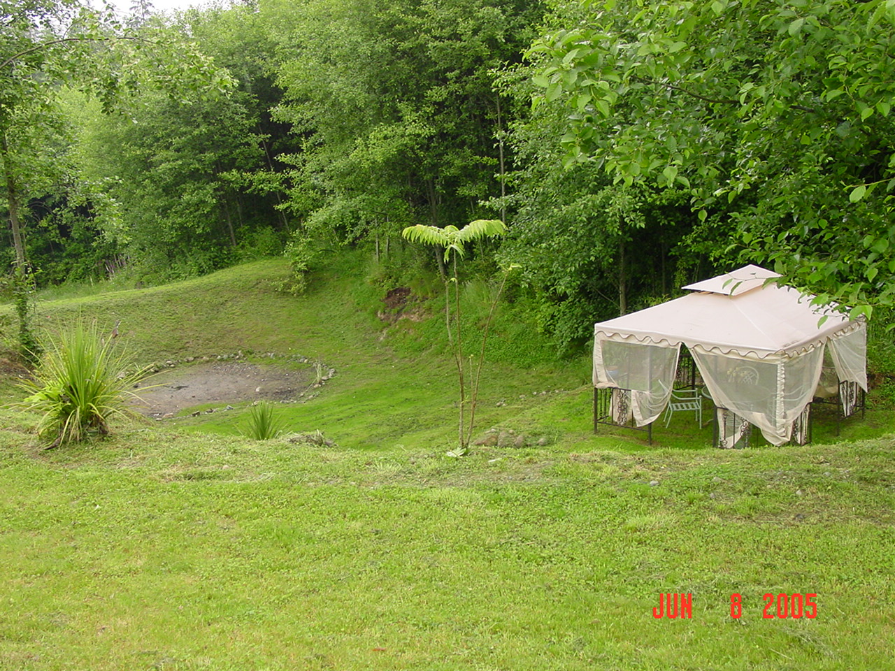

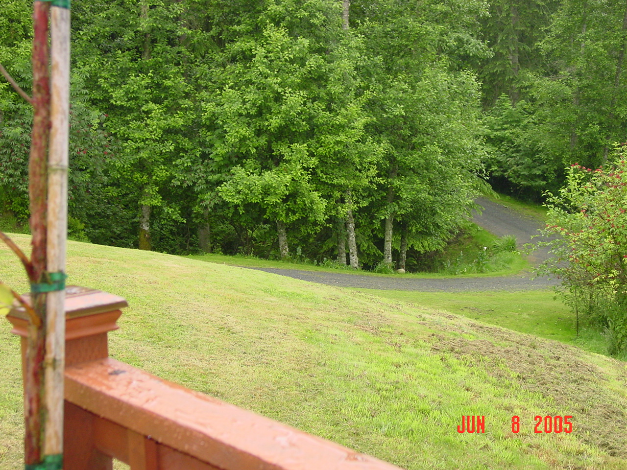

Next year I am moving NW of the Seattle area to a home on 5 rolling acres. It gets big weeds, tall brush and grass. It is a very hilly area.
Besides mowing I would like a piece of equipment with a variety of attachments available. Maybe a small snowplow, post digger, blade, and especially a bucket for digging ditches. Which so far has brought my interest to the Toolcat. I particularly like the relative smallness and the dumpbed. I don't like $25-$30K however. What else is there? I am more inclined to buy an American made product.

Your land is very hilly. I would stay away from compact utility tractors. They are too unstable on hilly land. Articulated tractors would make more sense. The PowerTracs would be great (425 or 420) and the other articulated tractors such as Steiner or Ventrec (?sp). There are all sorts of useful purpose built attachments for the PTs. They are really the "Swiss Army Knives" of the tractor world. Check out the PowerTrac forum and ask Bob Skurka about his Ventrec.

I agree with IslandTractor. I would more than exceed my "pucker power" :eek: on your property with my CUT. CUT's really do not like leaning more than 15 - 20 degrees. Jay

Nice place. But way too hilly for a small CUT. I have a Kubota B7510HST that I would never try to use on hills as steep as yours. The 7510 only has about 48" wide track, much too narrow to work safely on your hills. My 1966 MF-135 diesel has 82" wide track and orchard tires filled with water. I still would hesitate to use the 135 on your hills.
Like others have recommended, think about a small articulated tractor that's designed for hilly terrain.

I have a tilt meter on my CUT. Maybe you can do 20 degrees but I get ready to hit the eject button at about 17 max. I'd need to change my shorts if I ever got to 20 degrees.
I'd say CUTs are comfortable on slopes up to about 12-13 degrees and anything more than that requires due caution and a very careful lookout for rocks on the uphill side and holes on the downhill side that might suddenly tip the tractor further.
