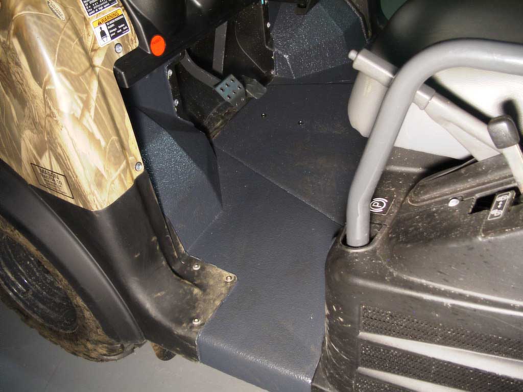

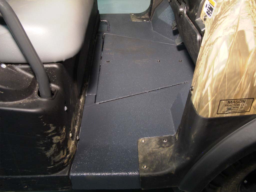

I sprayed my RTV with Perma-Tech liner. I chose Perma-Tech because I sell them at my Truck Accessory store and love the product. The low pressure products end up a little softer then the other systems and tend to cushion the bed a little better. They also keep things from sliding very well. I hauled loads of rocks in my unit to line my drive way. These field rocks range from baseball size to football size. After dumping many many loads there is no damage to the liner. Many Perma-Tech dealers like myself have the ability to spray colors other that back and can mix custom colors. I went with Kubota Gray and it looks real nice. I also pulled the floor mats out and sprayed the floorboard and firewall under the dash. To fill the holes in the floorboard you just simply put a very small piece of tape over the hole before you spray. Now when I wash my RTV, water and mud don't get under the mat.
Give it a try....
