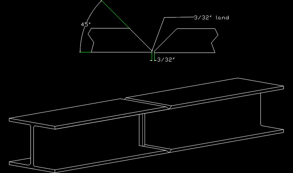

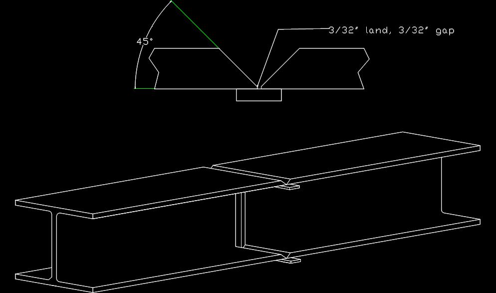

   / What sort of steel are building I beams made of? #5
There is nothing in the world wrong with using 6010 for the root when splicing beams. 6010 works best for open root. If you go with a backing bar 7018 is fine for the complete weld.
Here is a few joint details for you to consider using.
   / What sort of steel are building I beams made of? #6
7018 is the preferred rod to use for welding structural steel. I don't recall AWS allowing use of 60xx rods for welding steel buildings/bridges. Anything 3/4" or less only requires 50F preheat. Above 3/4" requires 200F preheat and a double V bevel to prevent distortion.
To my knowledge almost all structural steel shapes are made from A-36 grade steel. The loading and span is governed by the weight of the steel member.
There are some structural steel beams that are low temp grade of carbon steel for use where weather temperatures get below -40F to prevent brittle fracture because of the extreme cold. These welds are usually PWHT after welding. Most folks in the USA don't have to deal with that though.
