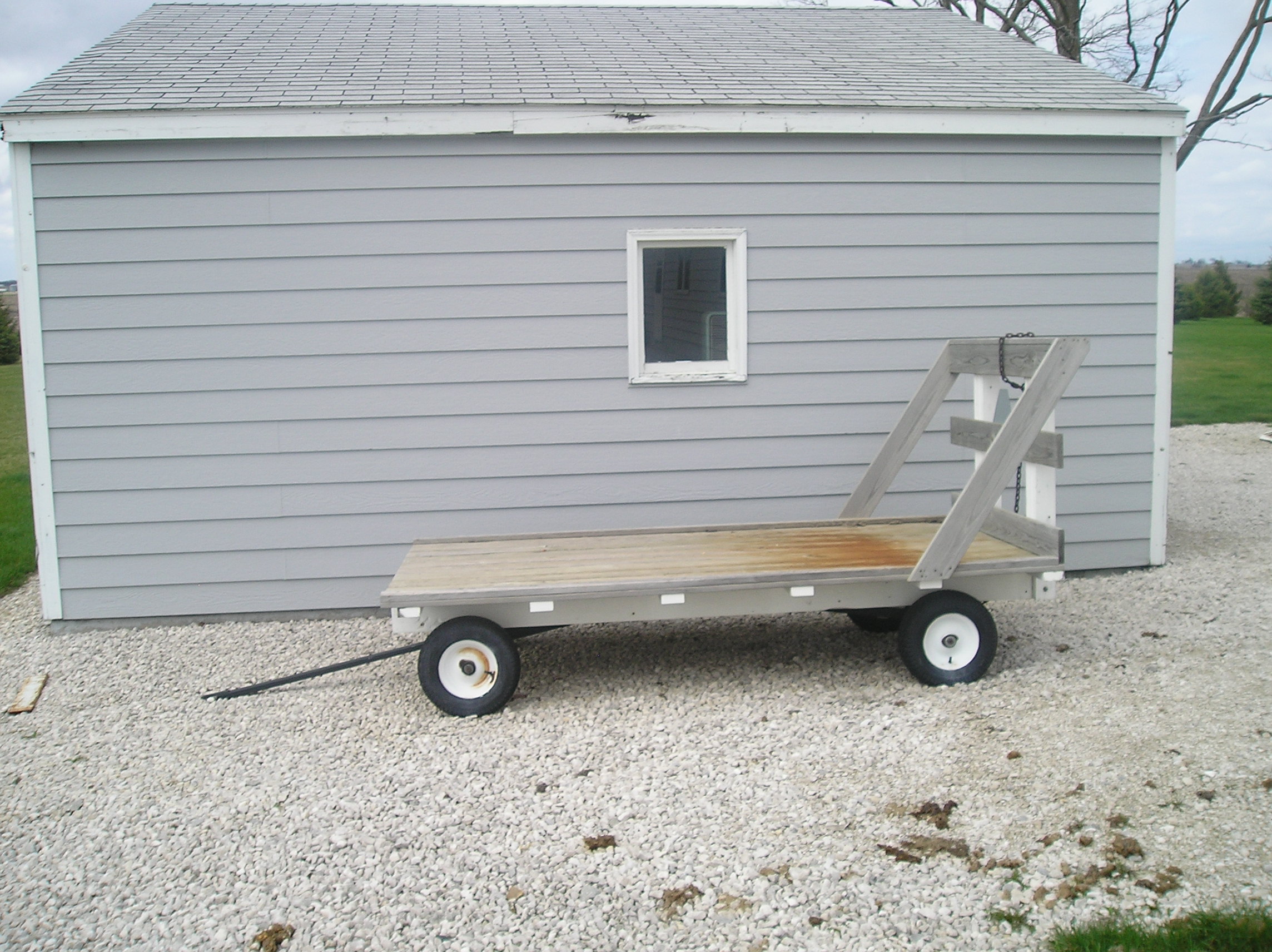

I'll go along with the rest of the gang and say 5X10. I made this one like a small hay rack. It has a 2000 LB. gear under it and the gator pulls it just fine.
