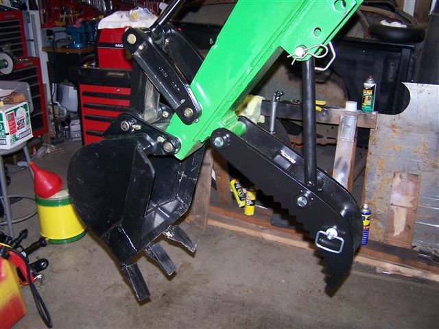

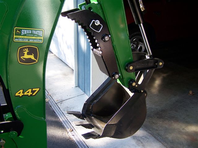

I've used the thumb primarily for yanking out tree stump roots. Rankin has 4 sizes of thumbs. Mine is their model UAT-100-R, and measures 19 1/2" from tip of thumb to pivot point. It has two open positions, 90 degrees to the dipper stick, and about 110 degrees.
