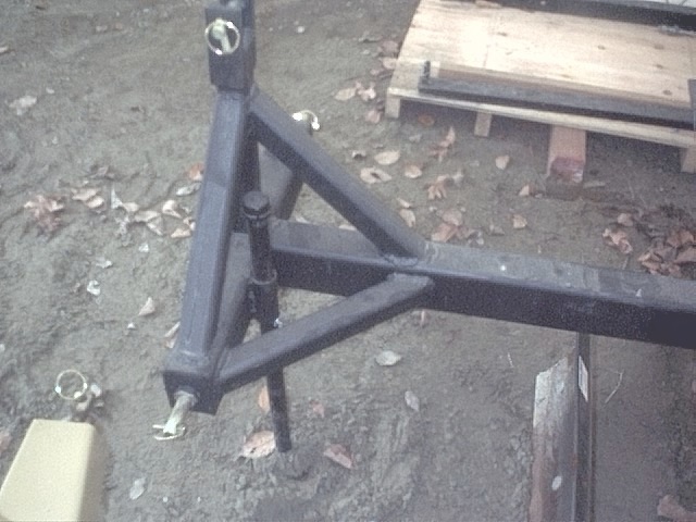

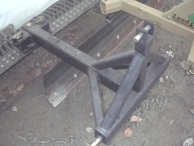

When I built my super heavy duty landscape rake, I tried to copy what Landpride used on their rear blades. I settled on 4"x3" rectangle tubing with 1/4" walls. Plenty strong. I used a piece for the span between the lift arms and another piece for the arm going out to the rake. I used 2"x2"x1/4" for the 3pt tower and for a few diagonal braces. See the attached picture.
The nice thing about using 4"x3" is that you can cut a small section out to get a wrench into where the lift pin nut is and have plenty of clearance. Otherwise you have to weld the nut.

   / What size square tubing for rear blade mount? #5
Here is a pic from another angle.

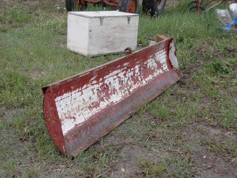

Just ran outside and took some pics of my own. Here is the blade of which I speak.
Front view.

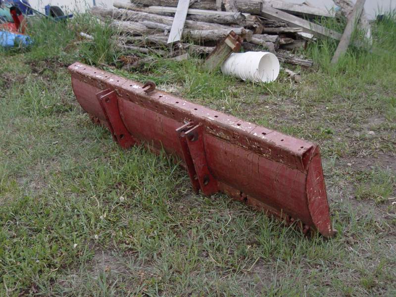

Back view. You can see it was set up to pin onto some sort of loader.

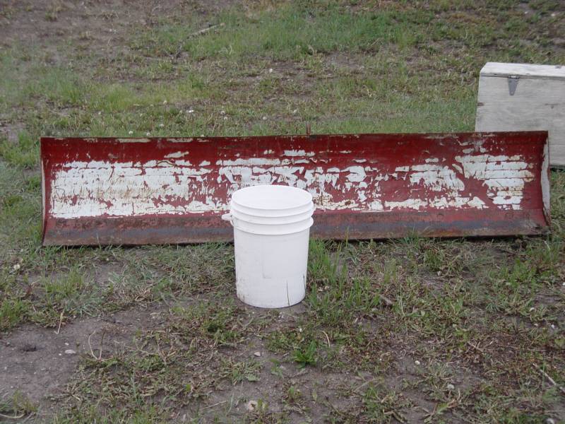

#9
With a 5 gal pail for size reference.

</font><font color="blue" class="small">( Good point about the rectangular tubing, but I'll likely weld "ears" on the horizontal crossmember to take the pins so the nuts are out in the open. I'm a little paranoid about welding nuts inside somewhere that would require a bunch of work to replace if they got stripped.)</font>
If you notice in this picture the horizontal crossmember has an end cap thru which the lift pin is attached. All you have to do is cutout the bottom 2" or 3" of the crossmember. With a 3" tube width this will give plenty of room to get a box wrench in there to access the lift pin nut. Welding the nut is not necessary. This method is simple to fabricate and makes for a nice clean and very strong installation.
