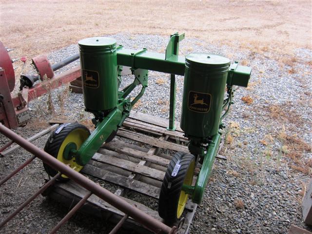

I have a jd 4520 and I'm looking for a row planter to put in food plots etc...what size could I get two three four row??? Thx

Might depend on your property. We use a two row for food plots at our camp. Even though on the 300 acres a lot of it is fields the small plots in the woods are hard to get to and a four row would be too wide on some of the back trails.

Your 3pt hitch has about 3000 lb lift and the pins. So you could easily handle a 2-row planter like my JD 71 planter seen in the photo on my Mahindra 5525 (which has specs close to your 4520). The planter weighs about 500 lb.
Bought that planter several years ago for $1K off eBay. Cost about $300 to ship from Minnesota to Northern CA.
YOu could handle a 3 or 4 row version of this JD71 2-row.
Good luck.

JD doesn't manufacture the 71 planter now. They are made by Yetter
71 Series
Don't know the price new, but my guess is about 3 times what I paid for my refurbished JD71's.
These planters are pretty simple in design. Not much to go wrong with them. Keep the drive chain lubed and you should be OK.
Good luck

For food plots, a 2-row planter is best (unless your plots are over 10 acres or so acres, when a 4-row would be better). With the 2-row, you can often get more corn, very easily, into tighter spots. For this reason, 2-row planters usually sell for more money at auctions, than 4-rows. This is due to their much higher demand. 4-row planters are too small for "real farmers", and to big for food-plotters/gardeners. They can be a real bargain however, for folks handy in metal fabrication, as many, like the JD 71, can be easily split into (2) 2 row planters.
Personally, I don't like the JD 71's, because they rarely contain fertilizer attachments. Yes, there are some folks who try and pass off insecticide attachments as "fertilizer". You will know you are being duped if the "fertilizer" hopper is smaller than the seed hopper. An insecticide applicator lacks both the capacity and the corrosion resistance to be used for fertilizer.
You can usually find an older planter, like a JD 246 (3-pt),/290 (pull type) or similar models by IH, MF, Ford, AC, with working fertilizer attachments, for less money than a JD 71 without. Those JD's use the same plates as the 71's and they are widely available. My JD 246 has been very dependable, over the 20 years I have owned it. Burying the fertilizer, only by the rows, has saved me many hundred dollars thru the years, compared to if I had broadcasted and hoped for a rain.
As far as hp goes, that don't come into play here, unless we are talking about a no-till planter. Even a medium sided ATV has plenty for a pull-type, like a JD 290. Your compact tractor could easily handle a 4 row, unless, if it was a 3-pt and the fertilizer hoppers were all filled to the top. Then you would need to add some ballast up front (iron weights or calcium filled tires). If it was no-till, you would be limited to a 2-row. I have never used, and know nothing about them.

It looks like they have really gone up in price in the 20 years since I got mine for $125. A quick internet search showed folks asking $1600-$1800 for planters with good looking fertilizer attachments. Those without are going for about half that. The one I got even has the rubber covered tires, meaning it was a later model 246. My fertilizer hoppers were in good shape at purchase, but since then, I have needed to patch them up a few times with epoxy. Lots of folks repair the metal fertilizer hoppers with plastic 5 gallon buckets. The shoes were badly worn on my 246 at purchase, but I was able to salvage a set of "like-new" ones from an old 290 "pull-type" that my father-in-law had. One of the lower, cast-iron housings on my fertilizer attachments also rusted thru, and unfortunately, that part was different on the 290. I needed to repair mine with some iron pipe, which was a relatively easy job. My planter was also missing the row markers, which are the same as those on the 290. I never use them anyhow, as it is easy to follow the planter marks across cultipacked soil, especially if you plant 90 degreed to the cultipacked direction. If I were buying a 246 with good fertilizer attachments today, I would say that anything under $1000 would be a good price.
