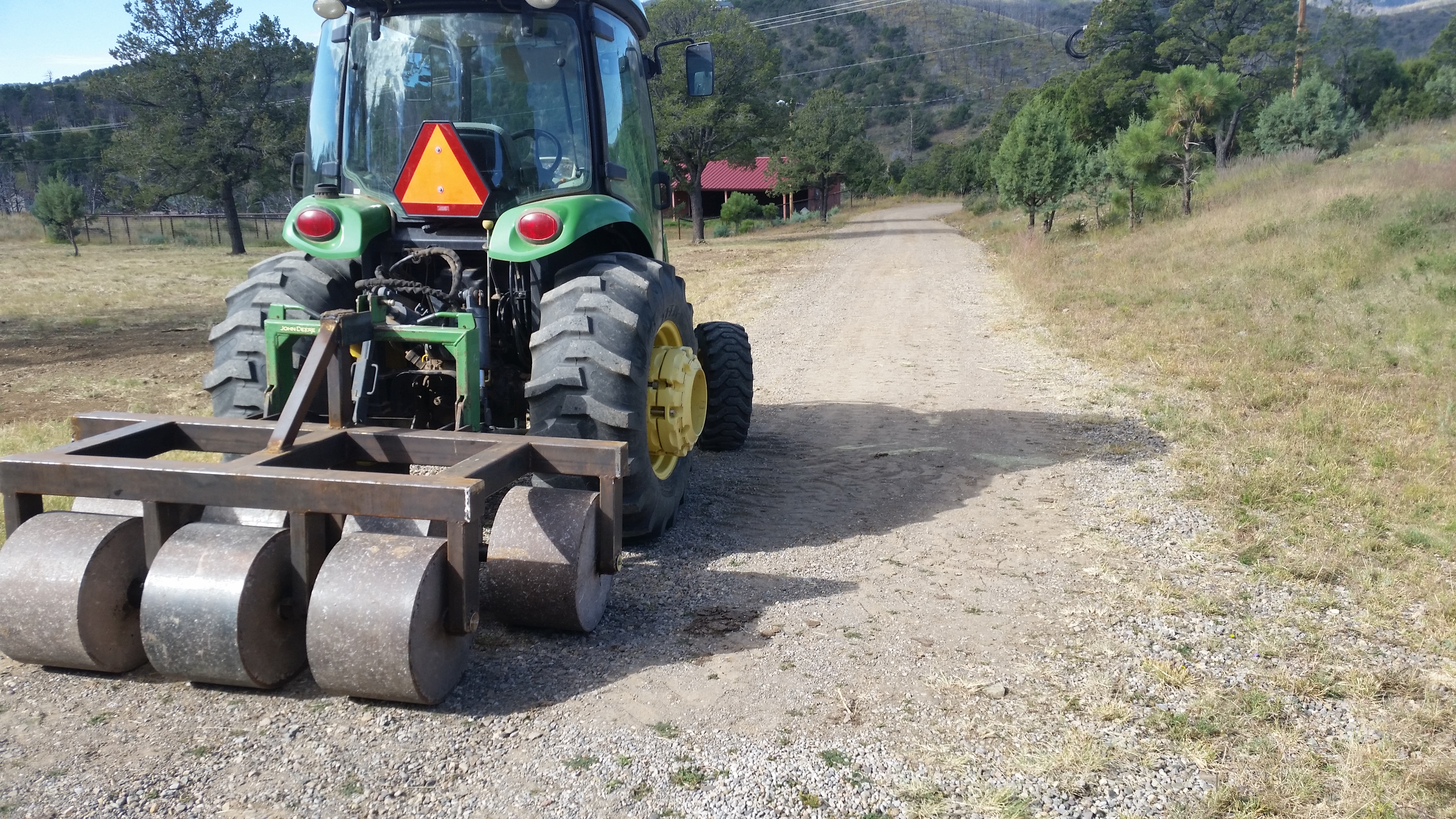

I have a small roller 36"x18" water filled roller that works okay for newly prepared lawn areas. This roller has about 130 lbs./ft of width. I like this for small jobs where I need to work on customer lawns as I can empty it and it weighs about 30 lbs without water. Easy to handle and work with and low cost single drum tow type.
For the tougher jobs I have a much heavier roller with over 400lbs./ft of width and about 2600 lbs. overall. Much better for packing down rocks and high spots. I use this for grading jobs where good compaction is needed. Easy to maneuver in tight turns with segmented rollers and quick hitch. Makes for quick changes between my land plane and roller without leaving the seat.

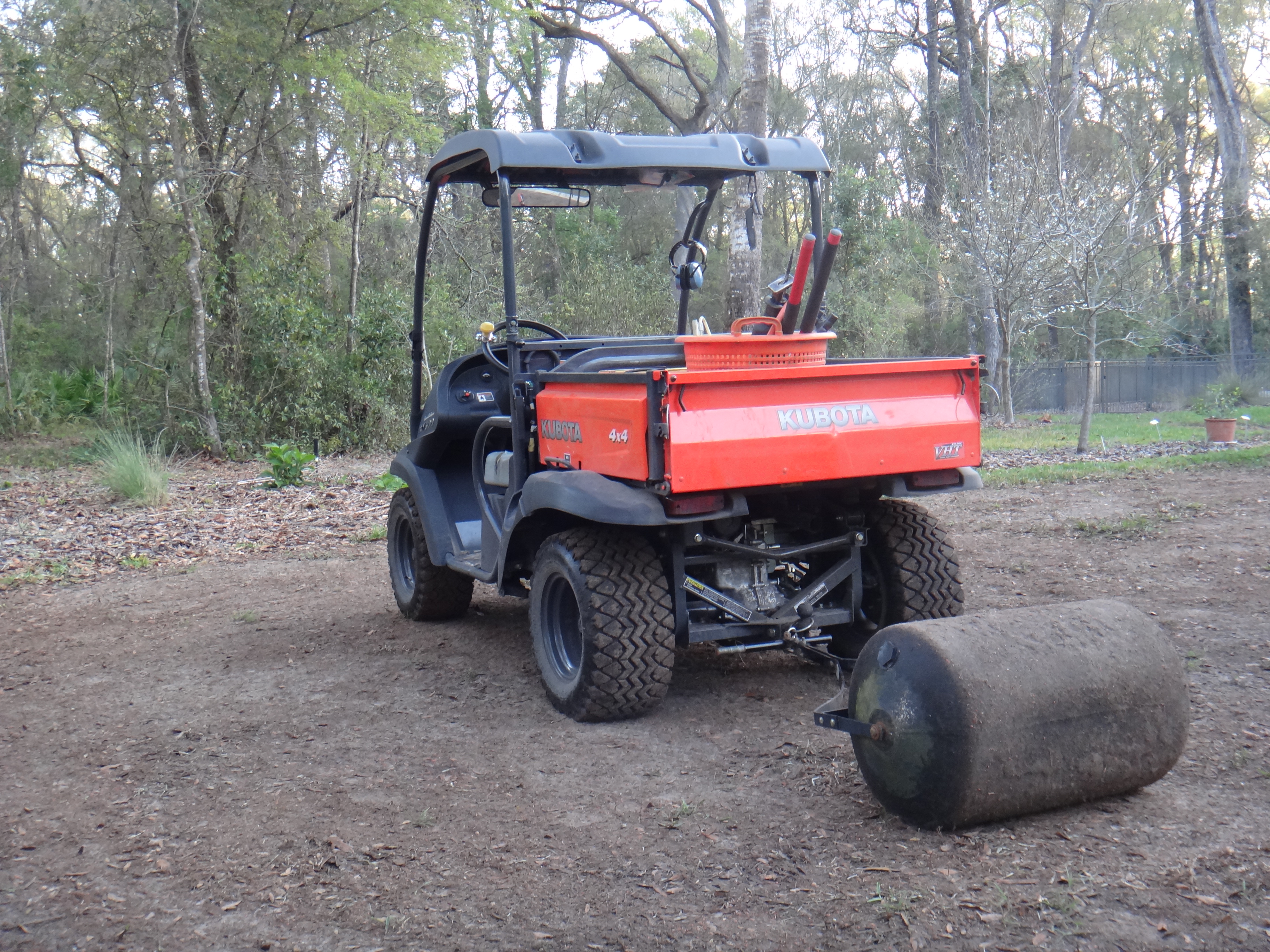

You can buy poly rollers at Tractor Supply Company (TSC) cheap.
You have to empty water before a hard freeze or they split. I have used the lightly built poly roller in photo for eight years in Florida.
However, if used on rough/bumpy ground something may give early. I only use my poly roller on turf.
For heavier duty applications consider a Cultipacker, especially if rolling in seed is part of the task.
Cultipackers are relatively easy to come by relative to heavy-duty, Three Point Hitch mounted steel rollers.
Ken Sweet has REALLY HEAVY, towed Cultipackers for sale most of the time.
MORE WEIGHT PER FOOT = MORE FLATTENING.
