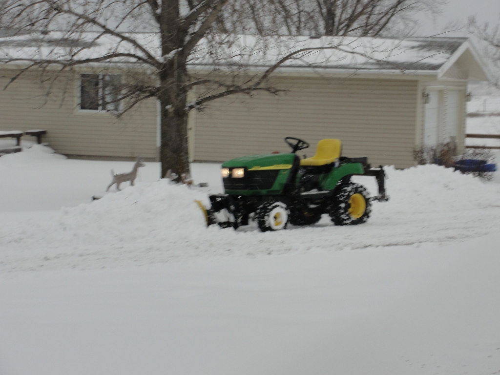

I use a 5' on the front of my little JD2210. The tractor measures 48" wide. It's barely wide enough. Wish it had another 6".

For a front blade for snow you want a little wider than your tires so it's just wide enough to cover your tracks when angled. I'm sure their are a few tricks to run a much wider blade. But for the typical home owner getting a blade that is too wide will just push you around on the machine. Front chains will help too.
If you find a used one that is a lot bigger I've seen lots of posts here where folks have cut the blade down.
